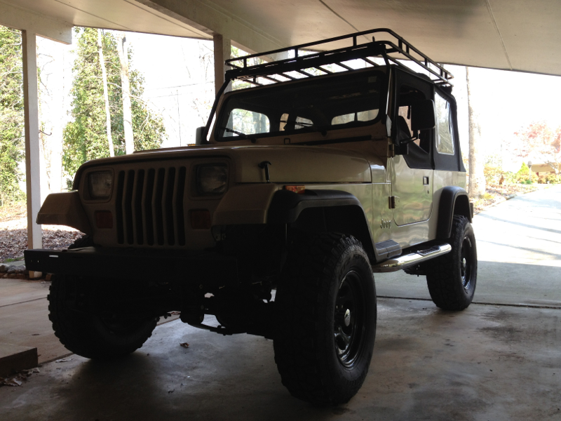

What size tires are those?

The angles look pretty good that's why I'm so confused tires are, 265 75 r16
That's equivalent to a 31" or 32" tire, and the pic looks like a solid 2.5" lift. I'd recommend removing the transfer case drop and checking the slip-yoke at the transfer case tailshaft to make sure there's enough spline engaged on the tailshaft. You really shouldn't have a t-case drop on there. If anything, maybe a 1/2" drop at most.

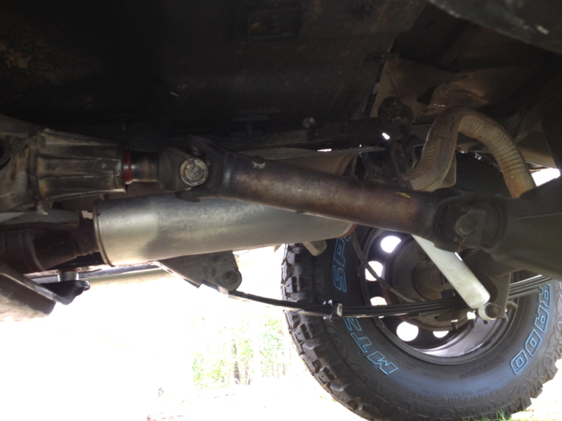

Can you post a pic of your rear driveshaft angles? Get the entire driveshaft and yokes from the side.

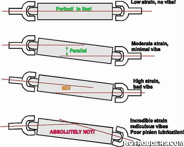

Your angles should be set up like this:
Here's the pic of my angels, tell me what you think. Thanx

The front and rear angles should be almost the same. Called cancelation angle.
I was about to say it looks fine, but then I remembered you dont have a SYE... You defenetly have an angle problem as described by Jester. Not sure if the TC Drop kit is the culprit, though, as I don't see removing it will cause the vibes to go away. Are you using degree shims or new shackles or anything else that may be changing the pinion angle?

Not using degree shims but will be looking into them. The shackles are new as well as the lift I put on some boomerang shackles that add 1/2" of lift.
I would stay away from shims... Most of them are aluminum, hich can crack, and that is just not good! Also, it seems your difference is just too much for them anyway. I would buy new perches and correct the angle the right way (welding obviously is involved here).
I had the same issue on my 95 Wrangler after adding a 4" lift to it. The slip yolk eliminator was the fix. If you do not add the SLE, then you will have u-joint issues.
I run shims steel ones that way when I do my sye I can change it easy shims won't crack unless improperly installed. I would look after that vibe ASAP though. Hard on the diff the t case and your teeth lol
