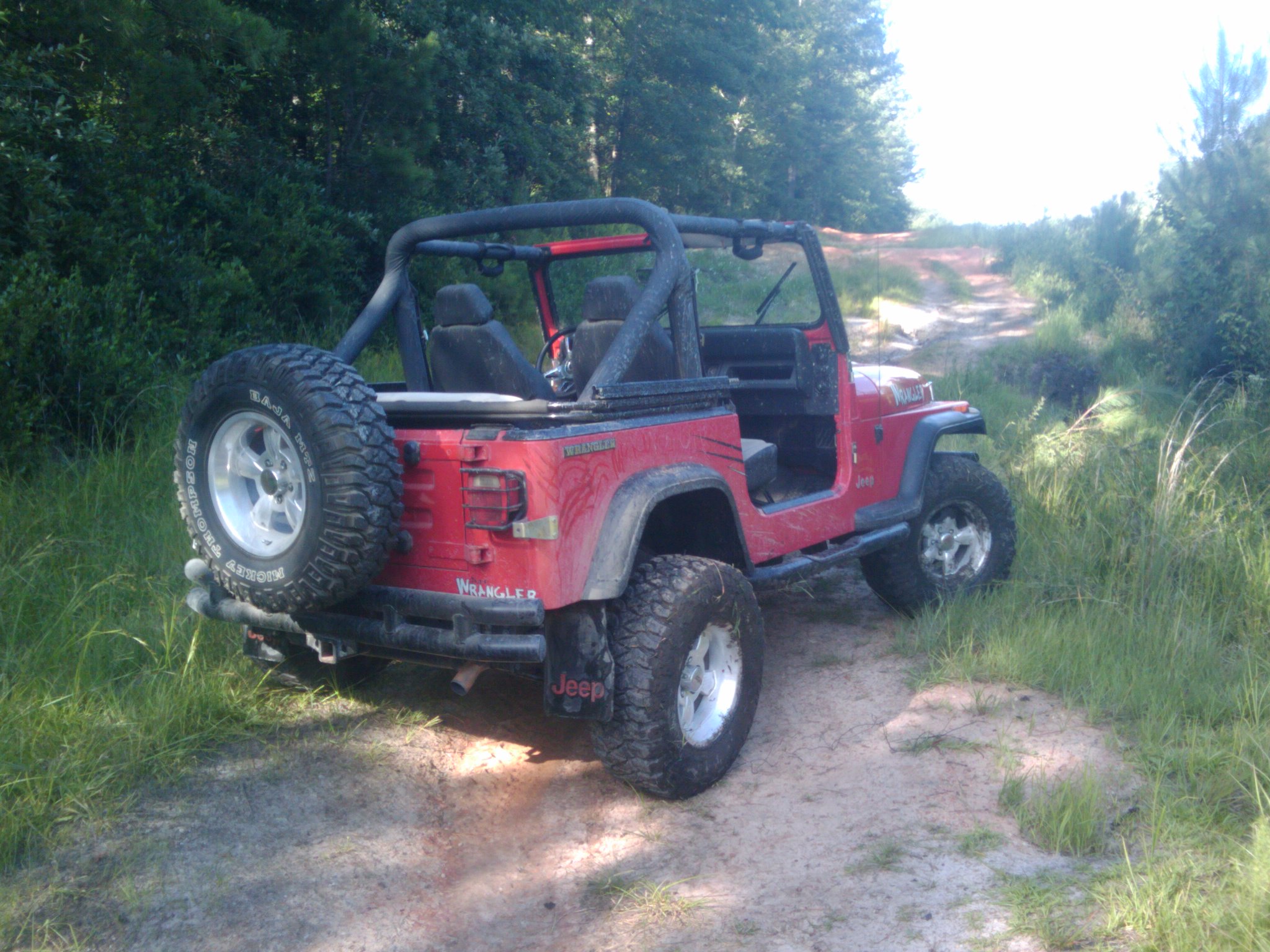

The picture below is from riding around today.

You need to upload some pictures I want to see it.

ok will do. but u'll have to wait till fri. im away from my baby for a few days.
