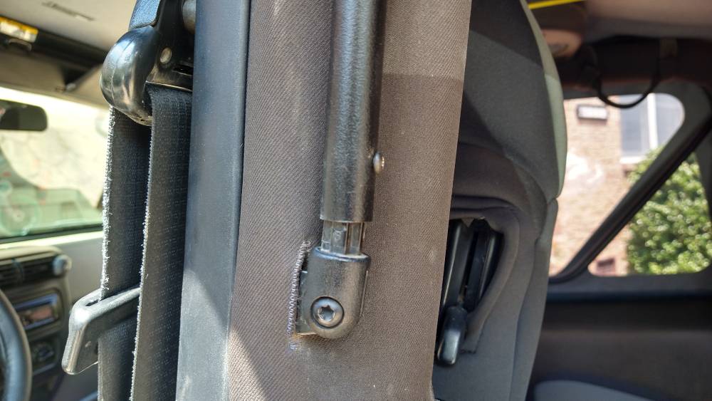

I've just gotten a new softop for my 2005 TJ (I'll post more on that later), and it's a bit baggy. I think it's a 97-06 top, and from what I understand, there were subtle changes in the 03-06 tops. After thinking this over, I think extending my softop frame connectors about an inch would really tighten things up a bit. These are the connectors I'm talking about
cacheJeepzImage.php
Anyone know where I could get the bottom two connectors (the ones that look like a lego guy's hand) that are about an inch longer? Any ideas on what I could fab up to make these myself?
You could likely draw these up and have them 3D printed. Check out you local library or HS shops.
Yeah, I thought about that, but my library is only open for carryout. I'm going to keep plugging away at it.
How much longer?
Consider a rubber spacer under it. Like bike tube or shrink wrap.
I ended up pulling the screw out and drilling a new hole. Worked really well and didn't cost anything.

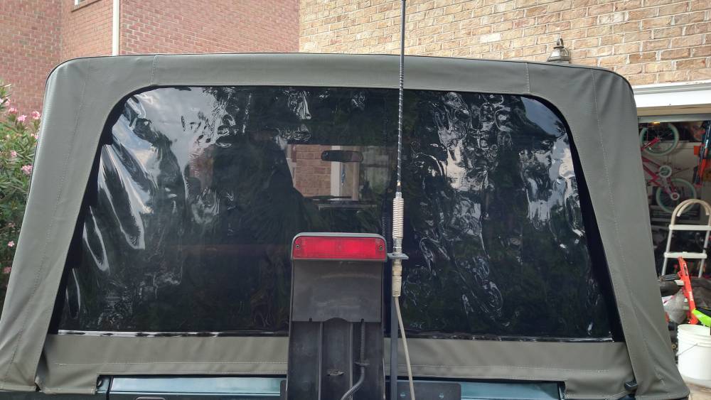

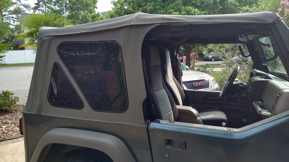

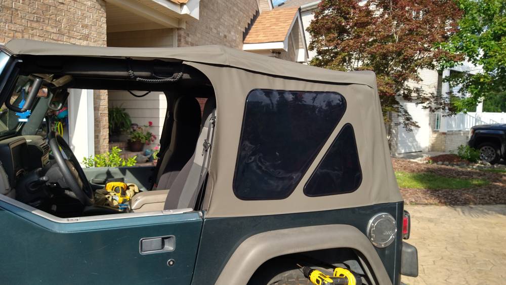

I just did mine today. The top is tight the side windows are baggy. May be the top??? Ill post pics. Mine is an unlimited. They only made them a few years so there shouldn’t be any differences.

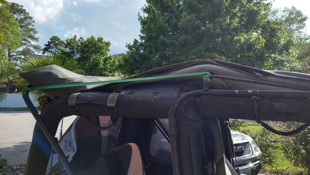

I fixed my problem by replacing the cloth straps. Mine had fallen off long ago, and I didn't think they were important, but they made a huge difference.
I took a ratchet strap and cut it up. Drilled out the rivets that held the old straps, and screwed the strap into place. I made it tighter than I thought it needed to be, and it turned out great.
