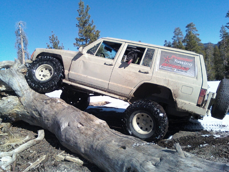

I used rustoleum satin finish on my aluminum wheels. I cleaned em with simple green and sprayed, thats it. They are banged up from wheeling but i wasnt worried about getting them perfect. The point is, theaint has held up well.

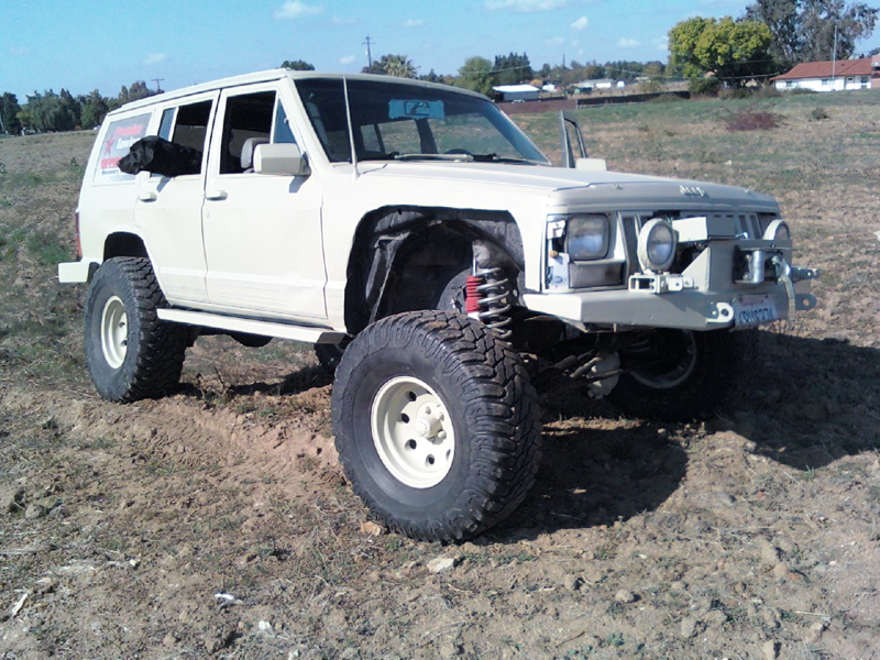

Done it a couple times. Once purple rims with a purple jeep!:o hah another time black rims on a white jeep. They looked pretty sharp. Just be sure there good and clean/ and spray paint away. Good luck!
Done it a couple times. Once with a purple jeep and purple rims! :o hah Another time white jeep Black rims. Looked Sharp. Just Clean rims up real good and paint away. Also a good way to avoid painting the tire is to put wd40 on the tire next to the rim once all tries you can wash off tire and any over spray.

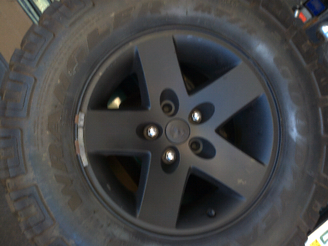

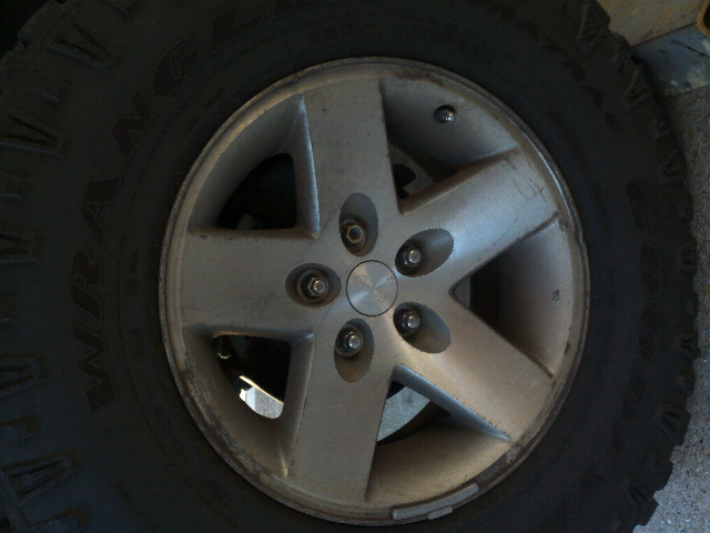

its funny u guys r talking about this i just started sanding mine to paint them black.
There is b4 and after I just finished today

First thing tomorrow morning! Now for the next question..
How and when to clean these fresh pained wheels!!

I would wait 48-72 hours. Depending on temp. Use a mild detergent and keep the pressure washer a fair distance away.

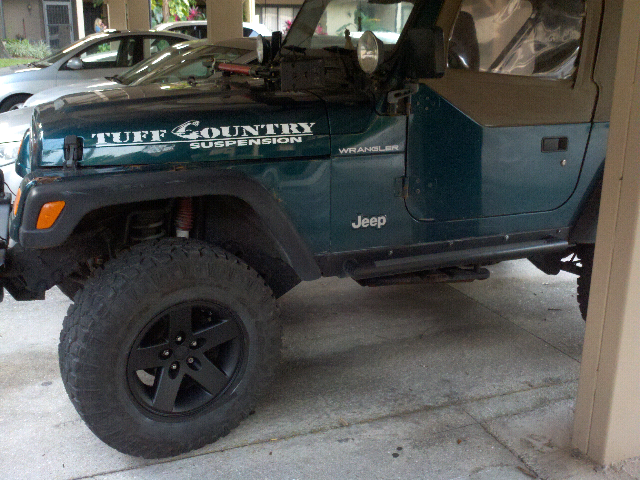

I'm not usually a fan of black rims, but on the white Jeep they look pretty sharp.
