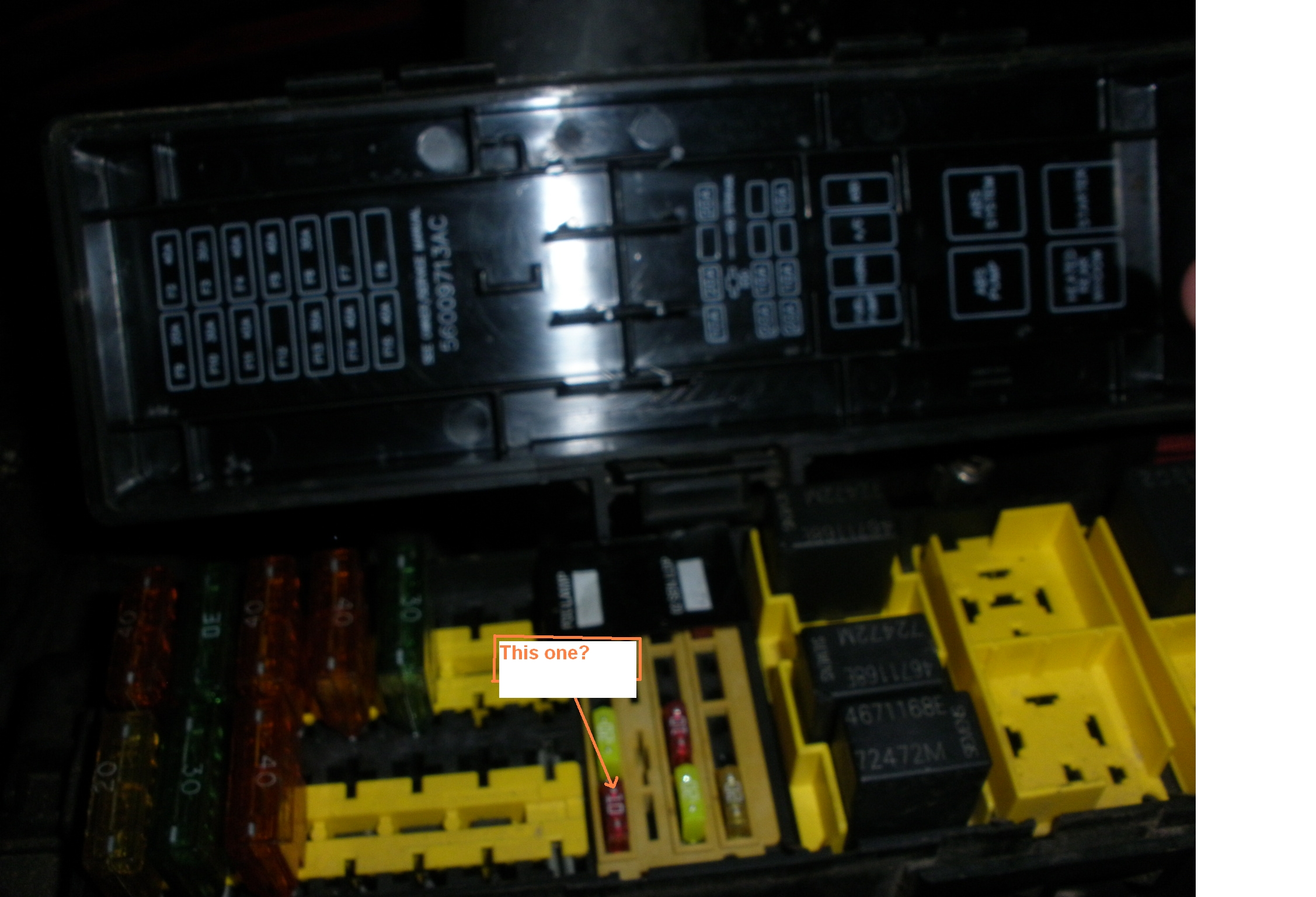

the PDC cover only tells me the fuse # for the maxis fuses and the relays there is nothing on the cover about the mini fuses. but on the cover it says(I0D storage) and there is nothing in my manual about the PDC fuses it only tell me what the fuses in the dash is for.
my pc wont let me upload the photo maybe i can email it to u
Here it is.
that fuse is 10amp it is the one up from that the yellow one which is 20 amp.. i think i mite have the problem sourced.. i had a new tow hitch and it has a intergrated wiring harness in it and i think one of the wires cut through i unhooked the hitch wiring and now the jeep seems to be running fine.. would this be the trouble or just a cooindince.
It's possible you've found the problem. If the circuit on that trailer wiring is linked to the fuel or ignition circuit and shorts to ground, it's likely that you have isolated the concern. Just keep driving the jeep and make sure the problem is fixed.
