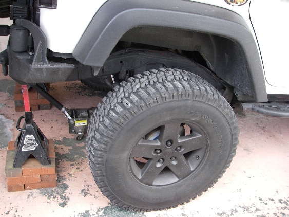

01 Jack up the Jeep and support it from the strong bumper.

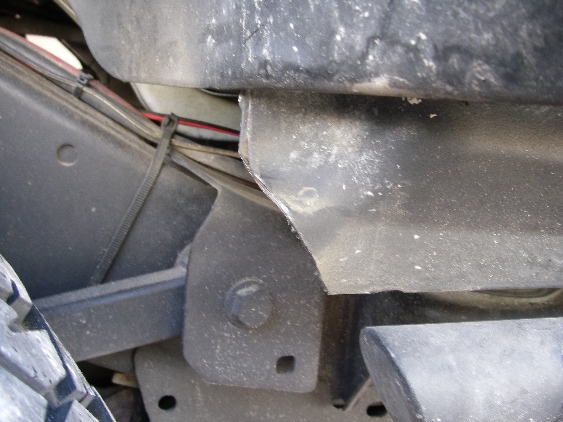

02 This is the piece your going to remove.

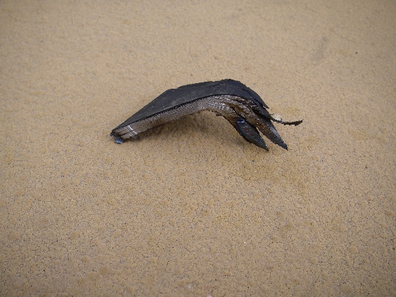

03 Use your cut off wheel to remove the piece.
04 The little pain piece removed.
05 Grind it smooth, Ospho it paint it and your done.
Mine did not have to be welded it is still held together by the factory spot welds. It took longer to jack the Jeep up than to do this mod.

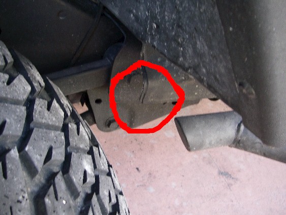

Is this something that needs to be done on all JKs? It looks like that metal / pinch weld could do some good damage to your tire.
It clears the tire by a few inches. Its far from necessary unless your putting BIG tires on with NO lift... It would be one of the many contact points. Mostly it just looks stupid so a lot of people cut it off.
