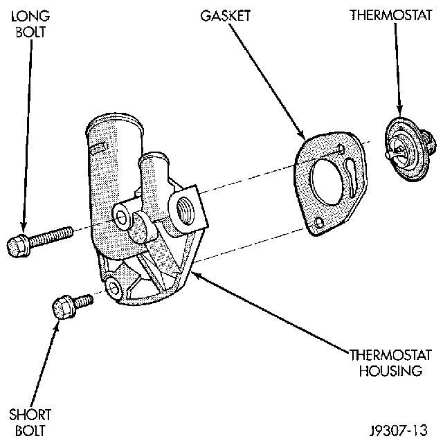

Hey everyone, I have a coolant leak coming from the upper house area where it goes into the motor, right near the cam I think dont know much about cars its a 92 4.0 inline 6 I tried that stuff that supposed to seal leaks but it only slowed it down. It drips at idle but when you shut it off it pours out for a minute or two, its not running hot thou but I did notice that now my oil pressure is going from a little below 40 at idle to a little under 80 while moving and I lost a little oil but I cant seem to find where it is coming from there is alot of oil residue around the valve cover thats all I can find.
Thermostat housing gasket?. The oil pressure is still normal. Stop leaks is never a fix, just a band aid. If anything else, it would contribute to a poor cooling system circulation issue on the radiator.

Is this a hard gasket to get to and fix? I live in an apartment and I cant really make a mess out in the parking lot. If I took it to a shop how much do you think it should run to fix?
It's not that complicated to do yourself in an apartment parking lot. 2 bolts,2 clamps then remove the t.stat housing and clean off the old gasket on both surface then install the new one and purge the air out of the cooling system and retest for leaks.
