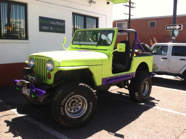

I just did a lot of work on my 81 cj7. I installed Performance Accessories 2 inch body mounts. I am happy with them. The biggest problem I had was the worn out holes where the others sat in. Dont think it really changed the ride much as my leaf springs are pretty darn stiff anyway.
