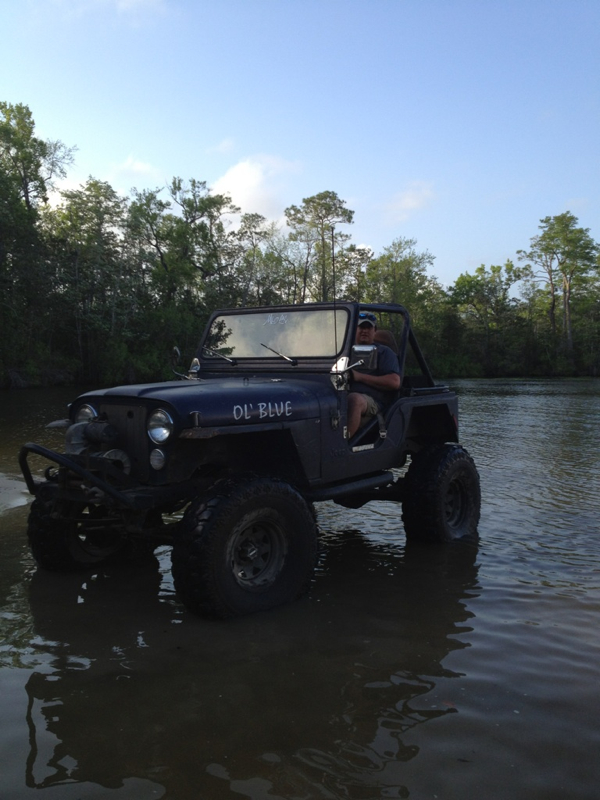

Just 32x11.50. Mostly trail riding. It gets a little tiring. I already a cj5 with 40's on it. Plan on staying a little more practical with this one
Was fun but wasn't very highway friendly
