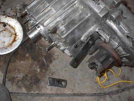

Ok so i took a few pictuers. In Fig.A im assuming this is the whole that the speedo goes into right? Fig.B this is the plug that i think came out of it. can i just detach the tip? Fig C. this is the transfer case linkage i cant seem to find where it attaches. Fig.D This is an area down from the linkage the silver bolt is just sitting in the slot the wire is holding it in place, any ideas??

The cable does go in that hole but your missing the little piece that holds it in the hole.
The linkage looks like its missing the piece on the transfer case that it would hook too
A: Yes, that's the speedo gear hole, you will also need the hold-down clip and bolt. It's similar to the Y clip that holds the distributor in the engine block.
B: That looks like half a speed sending unit, the cable should unscrew from that. They're plentiful in the junkyards.

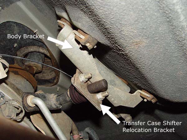

C: Directly next to the driveshaft CV joint, you will see a threaded rod with no nut. There should be a flat metal bar attached to this with a 9/16" nut. The flat metal bar will have a hole in the opposite end. There's then a metal rod that attaches to this flat bar and the flat bar you see as part of the shift linkage. Both ends of the metal rod insert into plastic bushings that fit in the flat metal bars.
Here's a pic of the transfer case bar:
This is the body end of the linkage:
D: looks like a bellhousing bolt that needs threaded back into the hole and tightened down.
Ok so i found the linkage bar under the seat. looks like it has the bushing on the end too so all i need is a 9/16 nut? and for the speedo, the end unscrews and then a new end goes on and then i need a clip and bolt as well? End=sensor?
