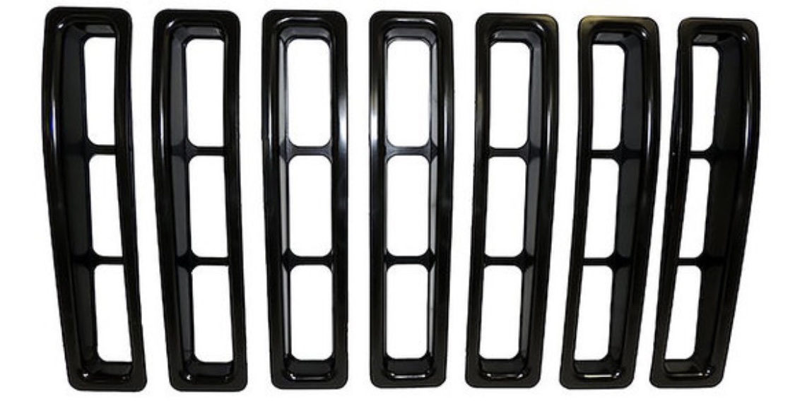

Another question. Do you have anything blocking the radiator? Wench or grill blackouts?

Well maybe. But it is something in front of the radiator disrupting airflow and pressure.
Others have found the same, wench has block air flow causing-overheating.

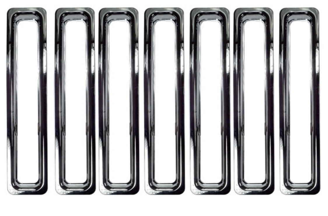

And nothing like these in the grill?
