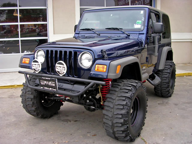

This is what I want my jeep to look like. NOTE: It's not mine!

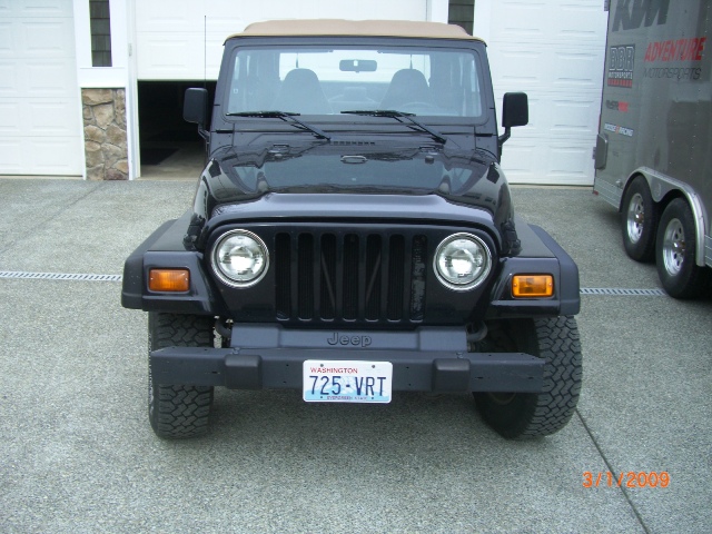

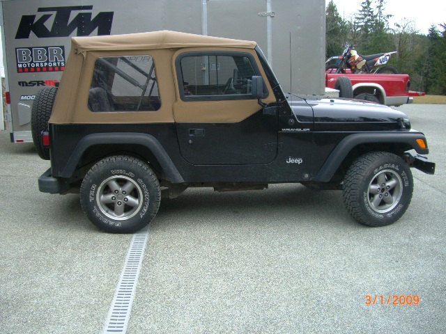

Right now its a 2.5L 4 cyl with a manual. But the first thing I might do to it is put either a straight 6 or v8 in it. I'll put an auto in it if i do put the v8 in.
But the jeep is pretty much bone stock, except for some oversized tires from the factory, which aren't really oversized. It does have the lower gear ratio for the differential since it's a 4 cyl. It was just a daily driver, and I was looking for something that is in great condition (which it is) to turn into my own creation. I've been looking around at different jeeps to find one that I like with all the specs listed, but the picture above doesn't have any specs.
