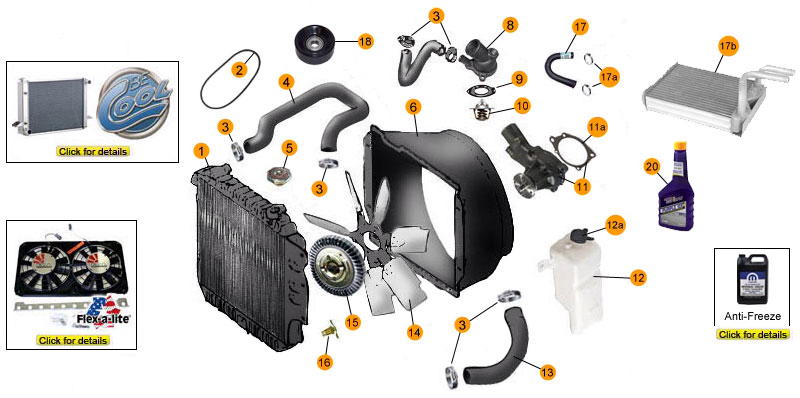

Have an 86 cj7 with the 6 cylinder. I am changing out the radiator and there is not an overflow bottle. Just a hose to nowhere going down by the side of the radiator.
I bought the bottle. Looking at pictures on line it looks to be installed next to the washer fluid but there are not any holes for it?
Do I need it? Did it come without one originally? Or is there another OEM style bottle that gets installed somewhere else?
image-4256295982.jpg It is needed. As fluid is heated it expands and pressure builds increasing the boiling point. The radiator cap limits the pressure to 16 psi that in turn limits the boiling point. While a higher boiling point sounds good many components will fail at high pressures. As the fluid pushed past the cap it gets caught in the expansion tank until the engine cools and sucks the coolant back into the system. Without the tank you lose the fluid and gain air in the system. Air allows more internal expansion and boiling to occurs at lower pressures.
I agree with JPNinPA...You need it.
Many older CJs did not come from the factory with an overflow bottle. I'm not sure about 1986, that may be why you don't have existing mounting holes, but it would be well worth the effort to add one on.
I have an 84 CJ7 and it has an overflow bottle next to the washer fluid bottle.
On that not, the cap on it doesn't snap on. Should I get a cap that works correctly?
I have an 84 CJ7 and it has an overflow bottle next to the washer fluid bottle. On that not, the cap on it doesn't snap on. Should I get a cap that works correctly?
the cap keeps dirt out and fluid from evaporating. It might be a good idea to put a cap on it.

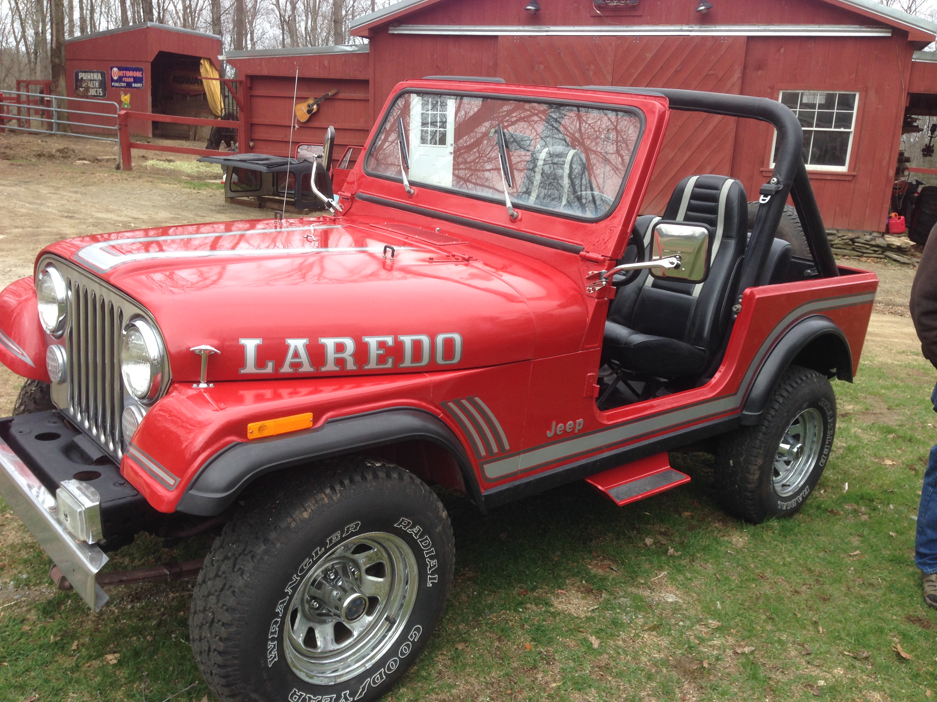

Great thank you for advice. I'll drill the holes. The bottle is shaped to go over what I believe is the Ignition Module (?). It looks like an aluminum housing that is pitted pretty bad. Does this part ever go bad? Should I change it before burying it?
It is not a show jeep just a seasonal daily river.
