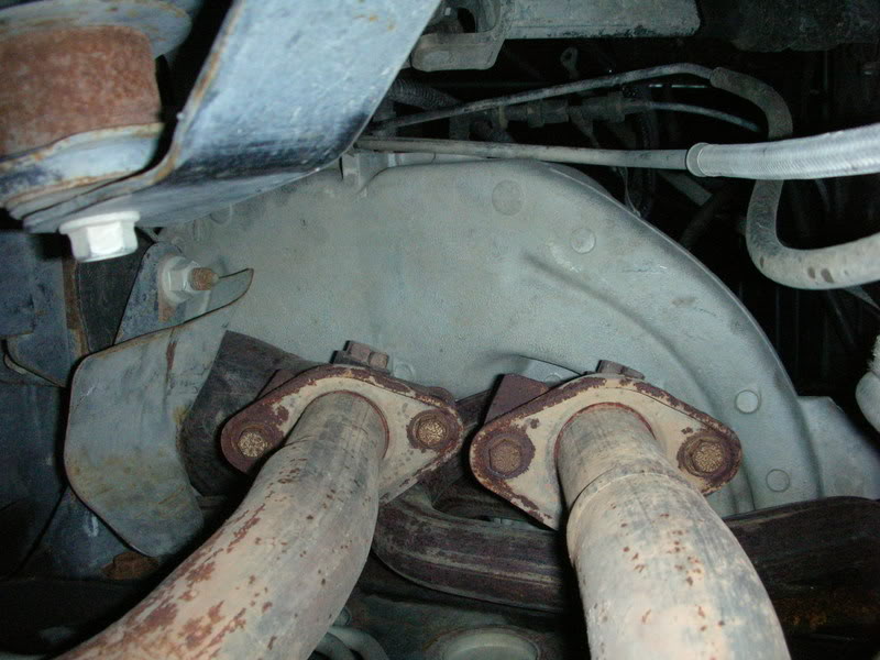

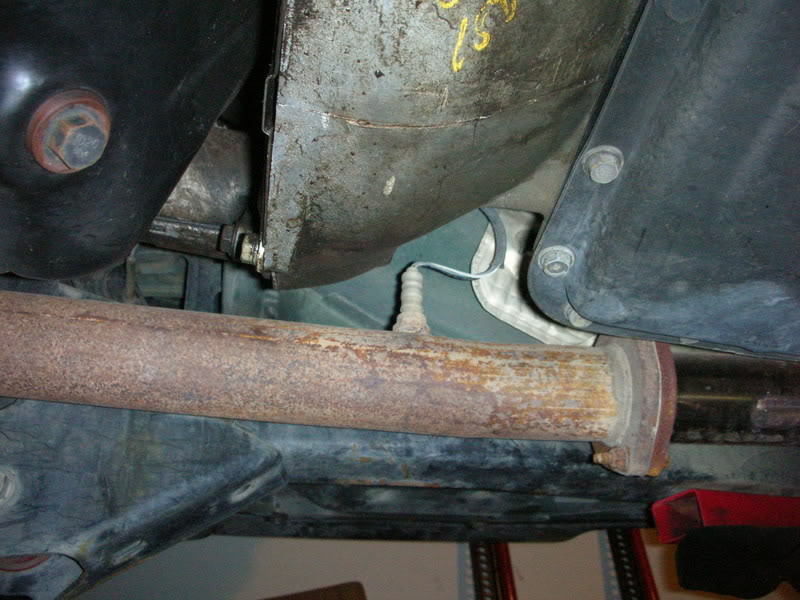

thanks for the help but in an odd twist i got under there yesterday to find that both upper o2 holes are plugged. There is another further down the header before the cat but i thought that was my down stream o2 sensor? I looked around for a good ten minutes and found no random plugs in the engine bay. I guess a picture of the engine bay pointing out where the o2 sensor wire comes from would be a help so i could try to figure this one out.
My thoughts were A the POs trail jammer taps the o2 sensor or B this is an aftermarket header and relocated the o2 sensor?

Chasing Ghost. that's a twist alright. the Wiring for the 02 sensors should be in the harness with the injectors, TPS , map. I didn't see any catalytic converters on your pics. does it have them?. I use to live in LasVegas and i know that you have Smog testing. did that change?
it doesnt have the mini cats on the header but i wasnt sure if that was only equipment for the CA emmissions jeeps since i dont remember mini cats on my 97 tj but i sold that a few years ago so i could be wrong. I wasnt sure so thats why i thought it might be an aftermarket header that relocated the o2 further down. In the second picture you can see the flange right after the sensor, thats my main cat, it was the same as my 97. But yes we do have emmisions down here in TX and i will be headed there tomorrow. Im pretty sure itll fail the first time since i cant imagine 2 year old gas burning too well. I filled it up on monday after i got my plates to try to dilute it.
miraculously the CEL was gone when i brought it to inspection yesterday and it passed, im checking the fuses this weekend when im in it for oil and spark plugs
