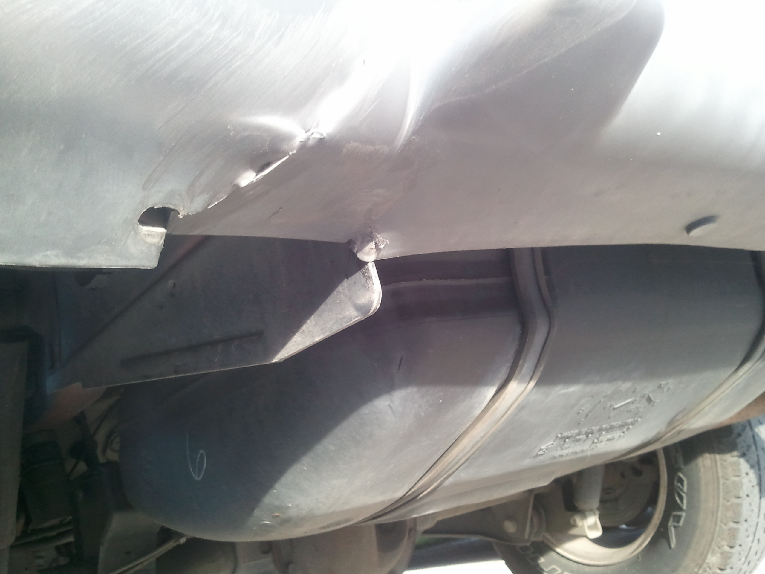

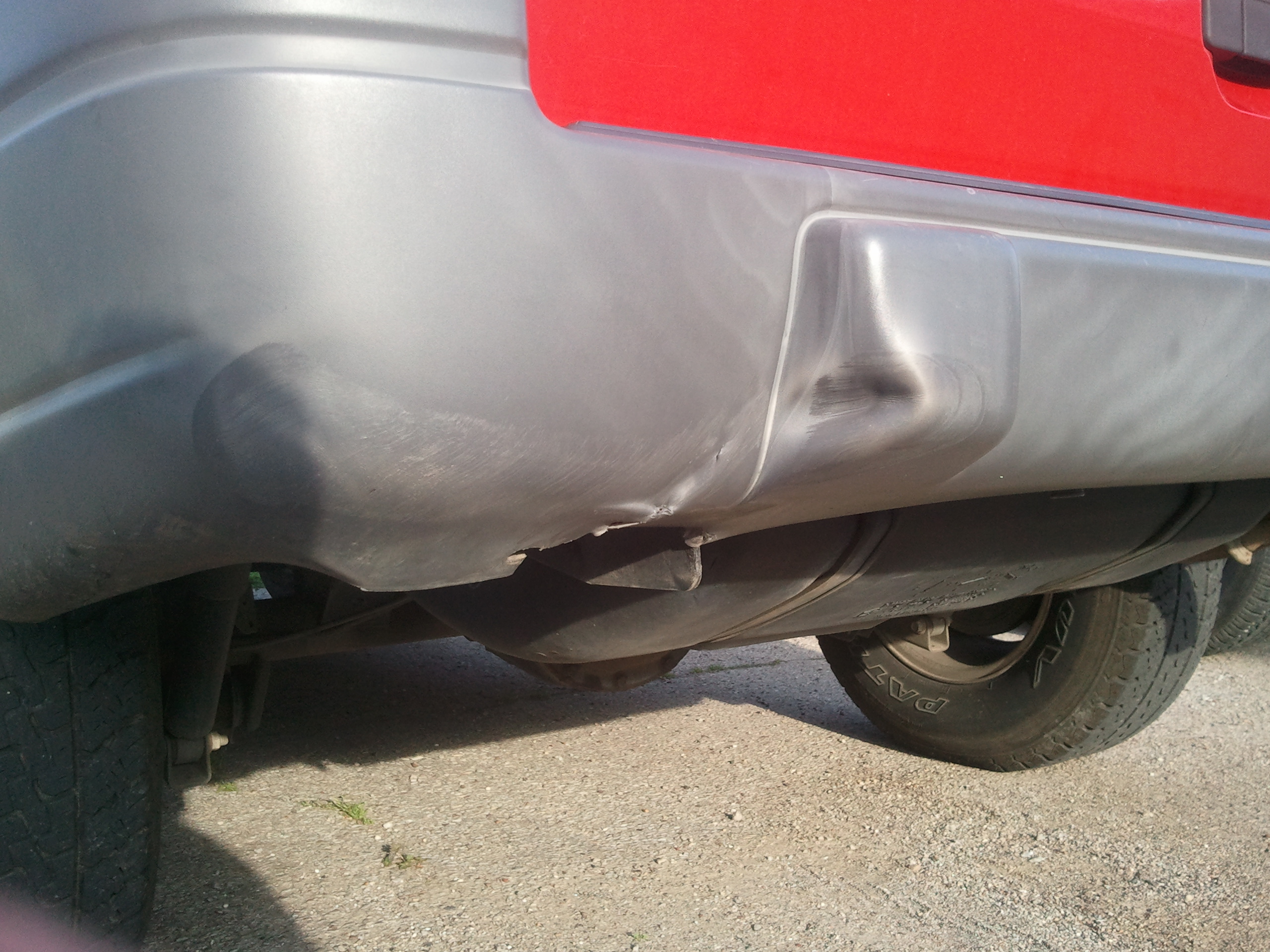

Here is the damage. I should also mention that I plan to put the bumper back if I can fix this. Any further suggestions?

The rip would have to be plastic welded and the dent you could work out with a heat gun. A body shop would just replace the whole assembly. It's attached all the way around the outside edges. Start at the fender wells and work your way to the fasteners under the hatch.
