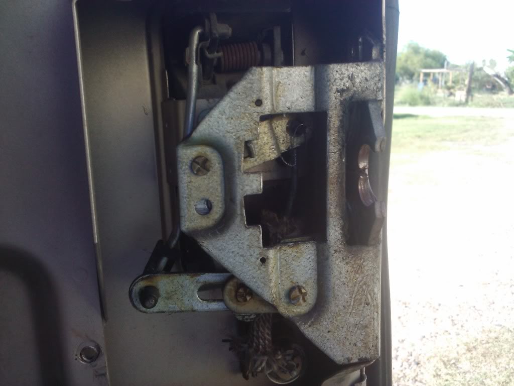

Having trouble with door lock getting stuck after locking door with key. Sprayed and soaked lock twice.
It also doesn"t help that the hard top & doors are from different donors. If all fails I will use a specialty tool a BFH.
finally got lock to work, found broken plastic clip that holds the rod in. Doors need work but the price was right.
I found pics of the lock mechanism while posting this pics in your other thread. These are 93 doors, which are the same
Ruh roh, never mind, this is the tailgate latch
