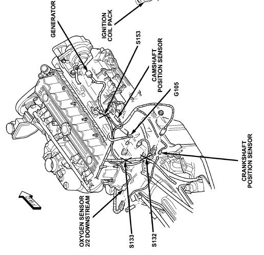

Do you need a wiring diagram?
FYI If you replace CKP get part from jeep.

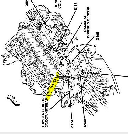

check for wire chaffing at the indicated area -
wil follow up thursday
