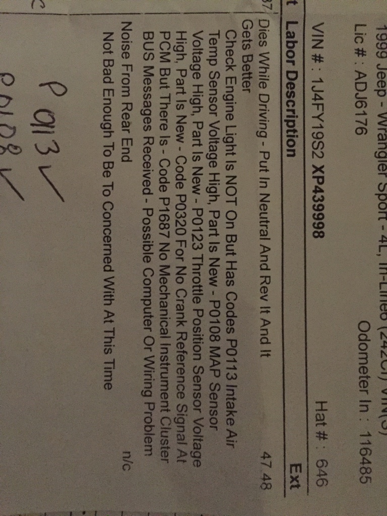

Just got it back from garage. This is what came up with no check engine light coming on.
So you happen to have a code for every sensor you changed.
First have your battery and alternator checked. Places like AZ and oreilly's do it for free. Second inspect ground and power wiring. Repkace any corroded wires. Clean to a bright shine all power and ground connections. Battery terminals and connectors.
Reset all connections to the sensors.
Clear your codes and reset your PCM and see if any codes return.
