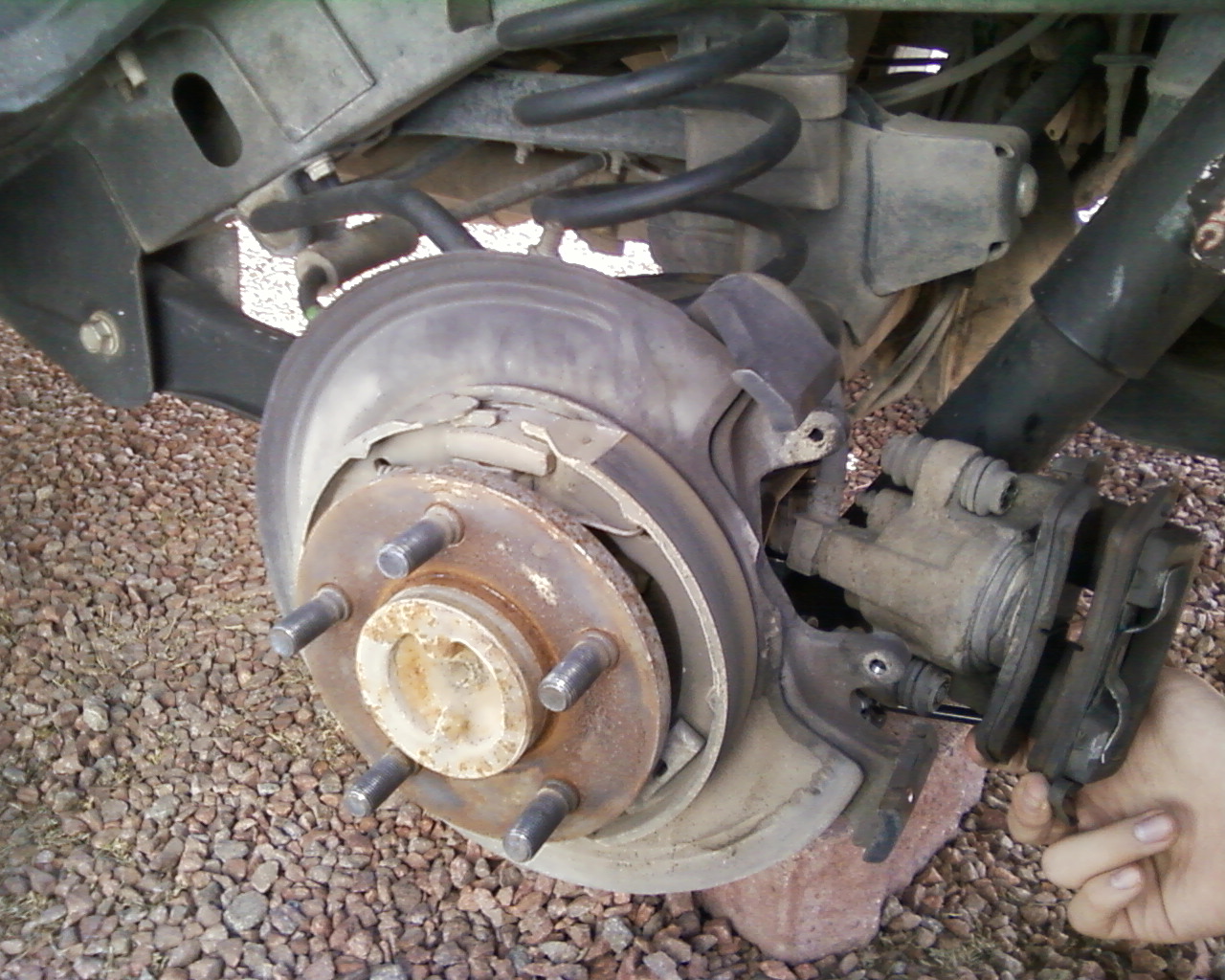

I'll get thous pics don this week end. do you want to see it with the tire off?

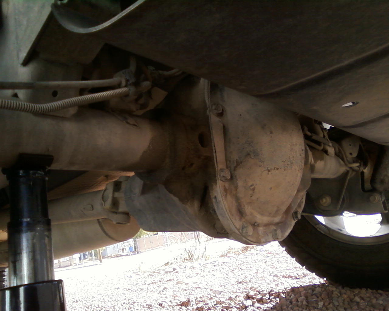

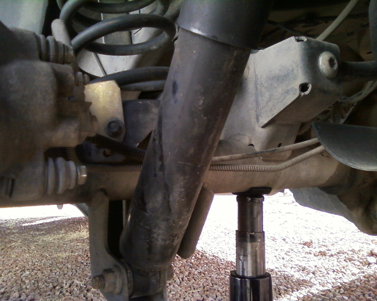

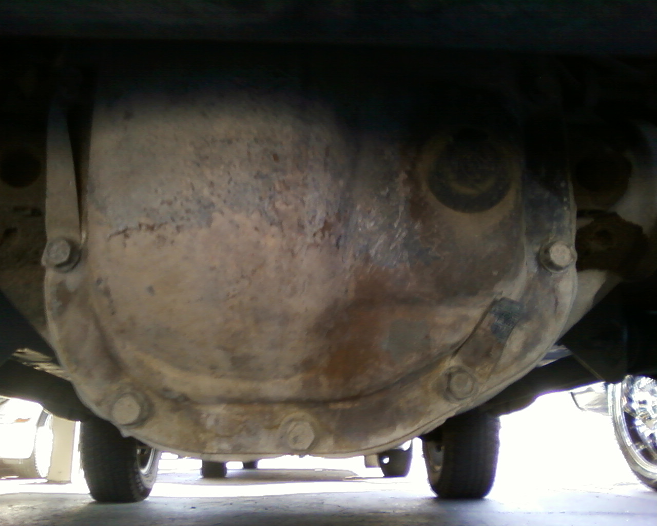

Here we go the pics of my axle, so I hop these help. What do you guys think?

Looks like the dana44a with aluminum center section. Take a magnet to the center chunk (not the cover) and see if it's aluminum or cast iron.
Tough to tell from the angle shot of the diff cover.
Ok I'll get more pics. and I'll try the magnet too monday after work bin busy today with the kids. I've don some looking and found that my model came standard with a trac-lock rear differential dos that help any too.
