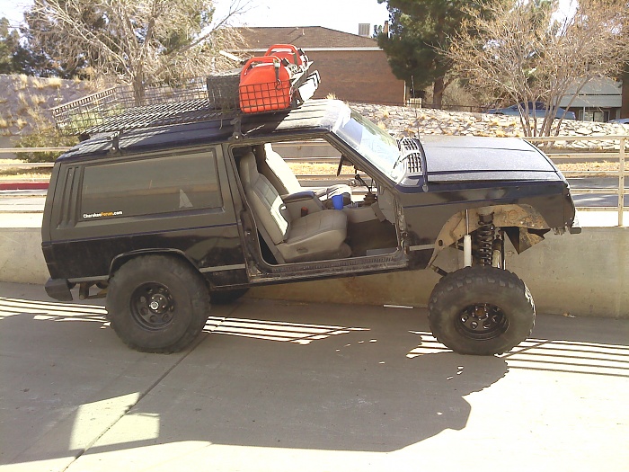

I must have been in a hurry when I responded and used poor words. With the shocks off, Try to get your suspension to do something like this. Passenger side front is extended, and driver side is compressed. Measure each side from top shock mount to lower shock mount. you will need a shock that measures "x" amount fully compressed, and "x" amount fully extended. This will give you the most out of your shocks and allow full use of your suspension travel.
thanks I didn't think about the compressed part of it
