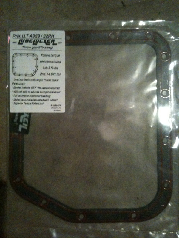

Yes, I'm no expert but I have to do this also. Put a jack stand up to support the front of the trans and put one up to support your transfer case. There then should be one in the front of your skid and one in the back. If you just unbolt your skid your gonna have a transmission in ur lap. OUCH!!! Good luck. If you have not gotten the gasket yet, I would recommend a "lube locker" gasket. Part number LLT-A999/32
