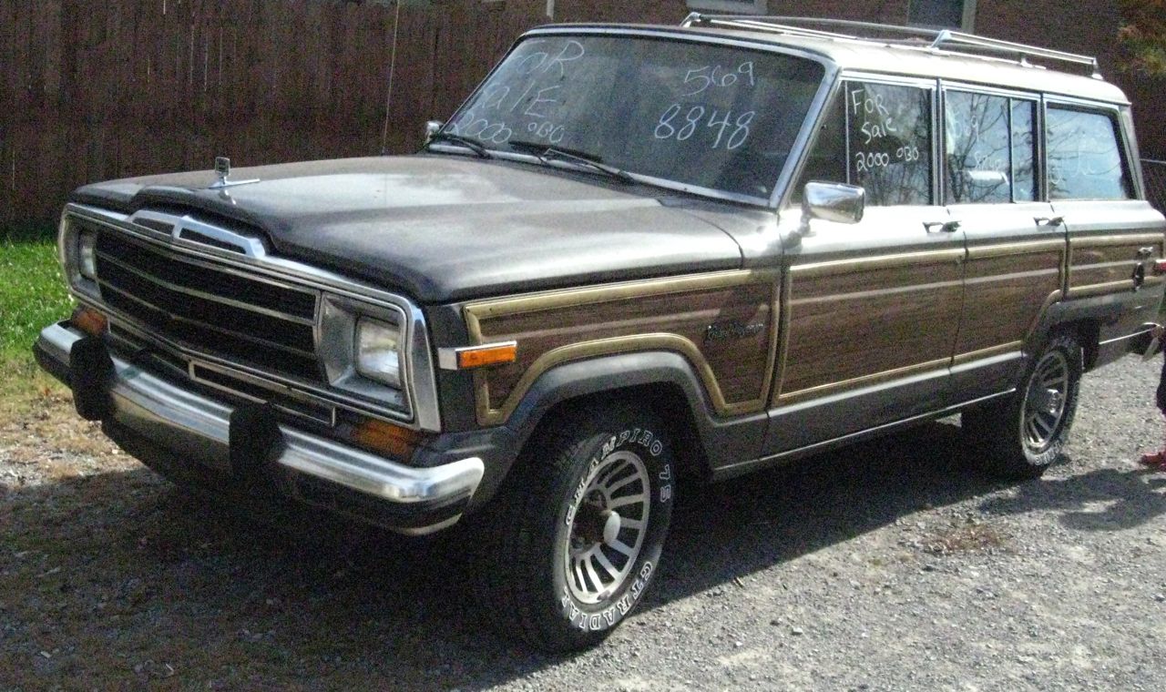

I bought an '89 Wagoneer today. It was stuck in 4wd and the seller said it would not shift out of first.
The tow truck driver lifted it by the rear and put it in neutral. About 1/2 mile from my house it started dripping smoking oil from the transmission case. The gear selector will no longer move out of neutral. Does anybody know what happened?
