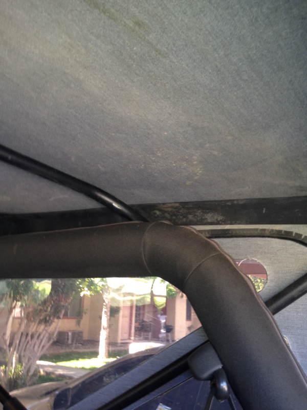

I'll post pic later of the inside of mine if it helps.

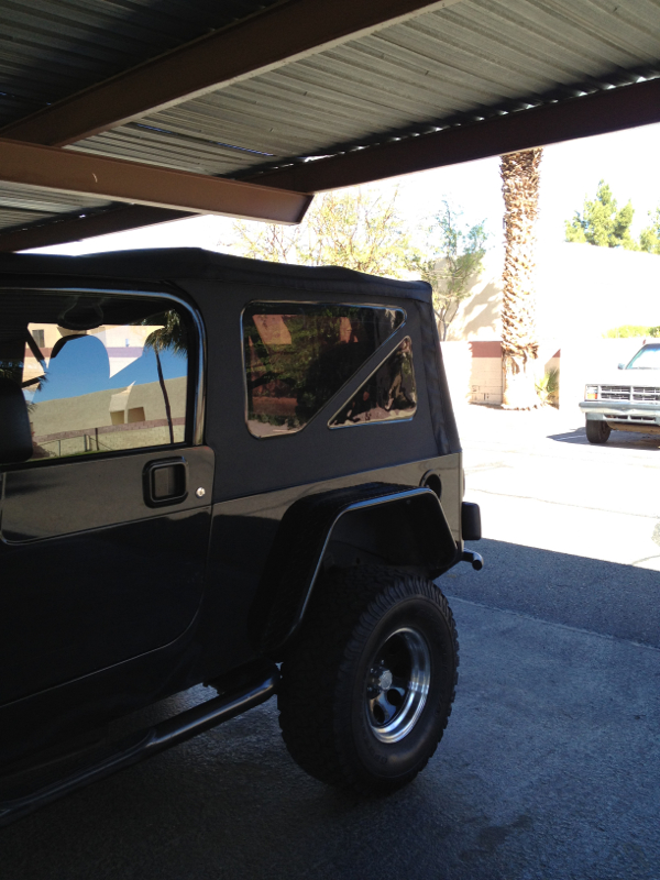

Alright. I've finally gotten around to taking pics I have several to show you how things look.

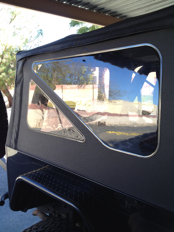

Right and left windows. You can see no puckering but they were hard as hell to zip.

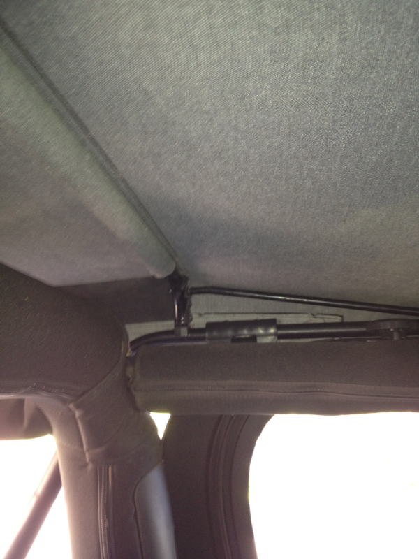

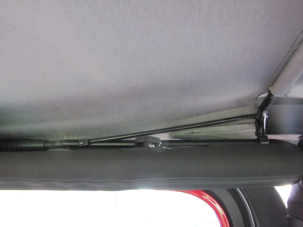

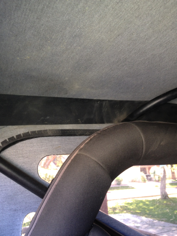

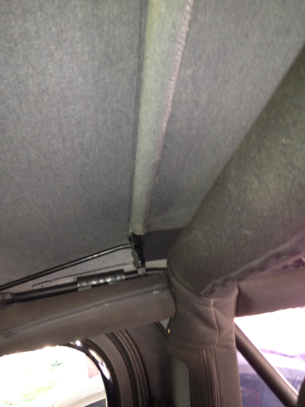

Right and left inside straps. As I said no twisting, or snagging. Looks just the same as it has for the last five years.

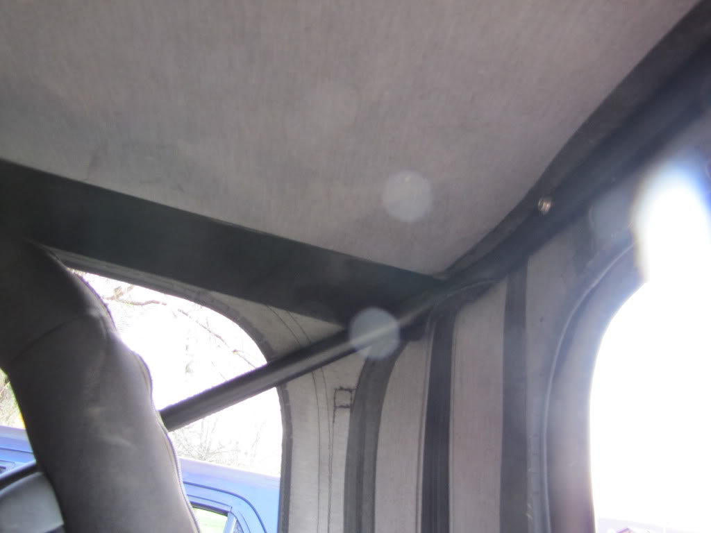

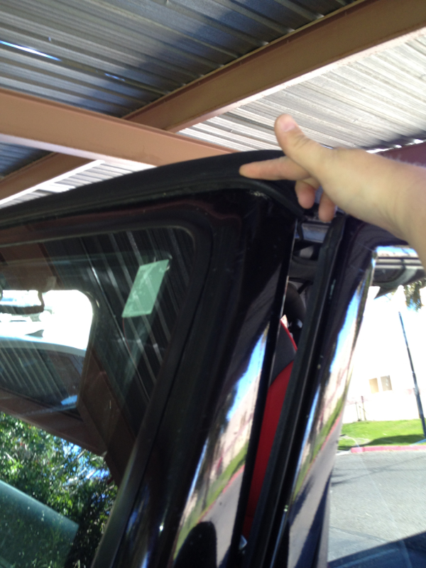

Drip rail at windshield.
More pics to come

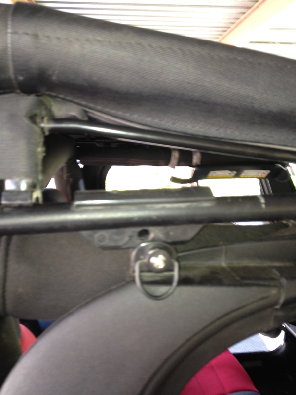

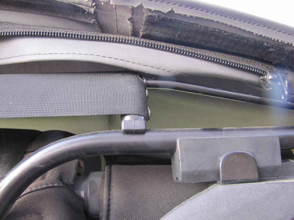

Bow from each side. And the quick release shown attached

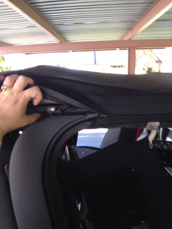

Finally, if I disconnect the quick release pin, this is about as cose as I can get it toward the mechanism without enlisting some help
Until this most recent encounter, I have been able to click that pin in place like I was closing a door.
