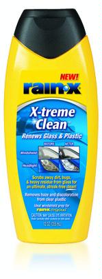

I've tried quite a few products to remove scratches, and the best I've found is Rain-X X-treme Clean Glass Cleaner. It works well and is cheap to boot.
Amazon.com: Rain-X 5080217 X-treme Clean Glass Cleaner - 12 oz.: Automotive
There are other products out there like Meguiar's PlastX and Bestop Vinyl Window Cleaner, and they don't seem to work any better than the Rain-X stuff. Honestly, if you've got deep scratches then you are probably just stuck - save up your money for a new set of windows (you don't have to buy a top, you can replace only the windows).

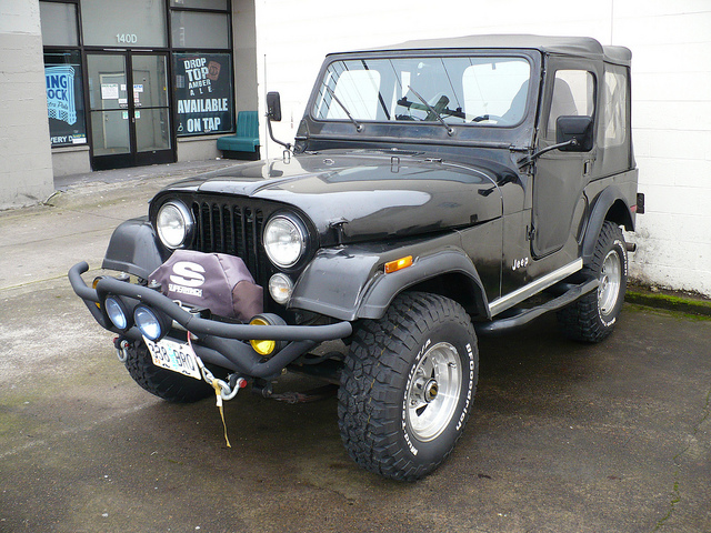

I've been using Bestop Vinyl Window Cleaner, but only for preservation thus far but five years ago when I got my replacement Supertop I was/am detirmined to keep it well taken care of given the great expense of this top. I get comments on it and many folks are surprised it looks so new.
