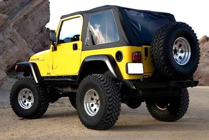

the top im looking at is the Rampage frameless trail top. it sayd instas over the original factory roll bars.

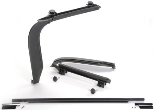

Do a Google search for TJ door surounds and windshield channel. There will be lots of pics etc. of them. The TJ needs these pieces to secure the soft top to the windshield frame and to fill in the gap between the door top and soft top.

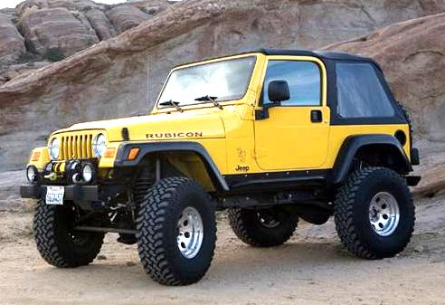

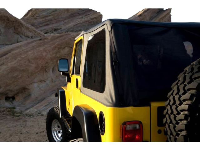

109535 - Rampage Products Frameless Trail Top with Tinted Windows for 97-06 Jeep® Wrangler TJ - Quadratec
The Rampage frameless soft top installs over the original equipment factory roll bar for a snug fit without the need for additional bows or support hardware. This unique design allows for larger side windows and improved visibility with removable side and rear windows that quickly convert the soft top into an open Island Top. Windows use heavy duty molded tooth zippers and are easily replaced or removed and stored in a special separation panel between the ceiling and roof top which is concealed and protects the windows from scratches or puncture. The fastback style offers improved aerodynamics and is considerably lighter then factory bow style tops. This top requires the use of the Mopar® factory door surrounds and tailgate bar, as well as a header windshield channel (sold separately).
I've never seen one one in person, but it looks OK. It's about $100 cheaper than a traditional top. If you get one then let us know what you think of it.

If your jeep never had a soft top then you'll need that door surround. It's pretty much the upper part of the door jamb where the soft top will attach to on the side. Likewise on the tailgate bar. These components are reusable from the old soft top if your just replacing it.

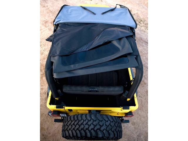

The factory top is secured to the soft top frame, and folds down on the frame. Without a frame you'd just have to fold the top up and lay it in the back seat. You already have to do that with your soft top uppers (if you have them) though.

Oh, and it's quicker to take off, about the same time to put back on. Getting those plastic fingers/lips/whatever things to snap into place around the tub is the same time consuming quickness as with the framed.

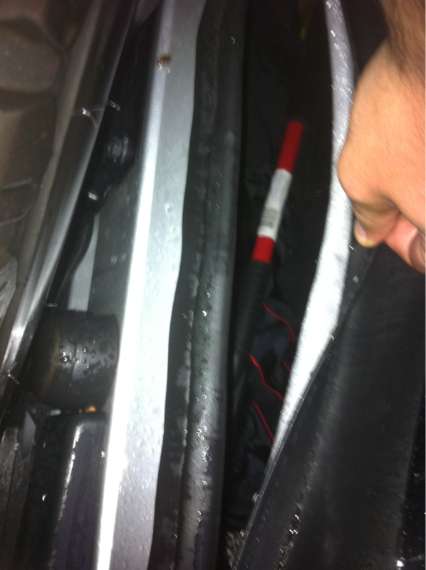

i do have a question though. sometimes there is space between the back window and the top of the tail gate. it wont always stay in front of it. has this happend to anyone? does water get it? what could be a solution?
........i do have a question though. sometimes there is space between the back window and the top of the tail gate. it wont always stay in front of it. has this happend to anyone? does water get it? what could be a solution?
Did your top include the aforementioned "tailgate bar"? My factory top has a bar that slides through a channel in the rear window and locks into place right above the tailgate. Doesn't hook to the tailgate, but when you shut it, it ain't moving......and it's a fairly watertight fit. I'm thinking that's what you're missing.
ur right, all they gave me was a strip of rubber that slides on top of the tail gate.
