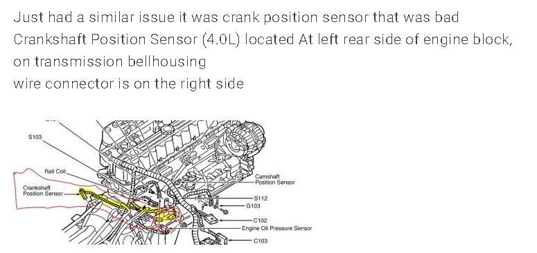

Like I thought, on the bell housing for the crank sensor....this will go, went on my 2001 around 89K miles
