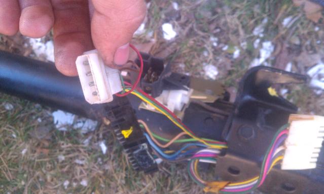

I recently changed my steering column and now my jeep won't start... I tried touching the poles on my starter and all I get is spark... I got the column out of a 88 xj with power Windows and locks and my xj is a 89 manual everything? Does that have any effect?... I'm kinda aggravated because its not easy switching them by yourself
Did you get it out of an auto or manual

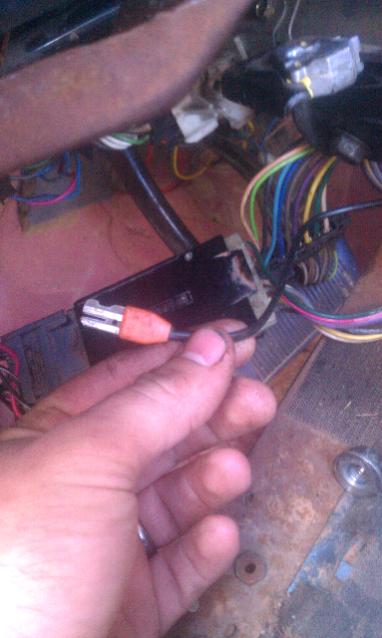

Both are auto.. the only difference in the two is one connection.. I traced my switch up because mine is pretty open and it went to were the blinked and cruise control are... ill take a pic of the two
The one with the white connection is my original one... the black one looks like maybe its for a horn but it comes out in the same place mine does....

Best to look at a wiring diagram for that jeep to see what you're dealing with. Ref the white plug, are there any tracers on the 4 wires or are they solid color?
