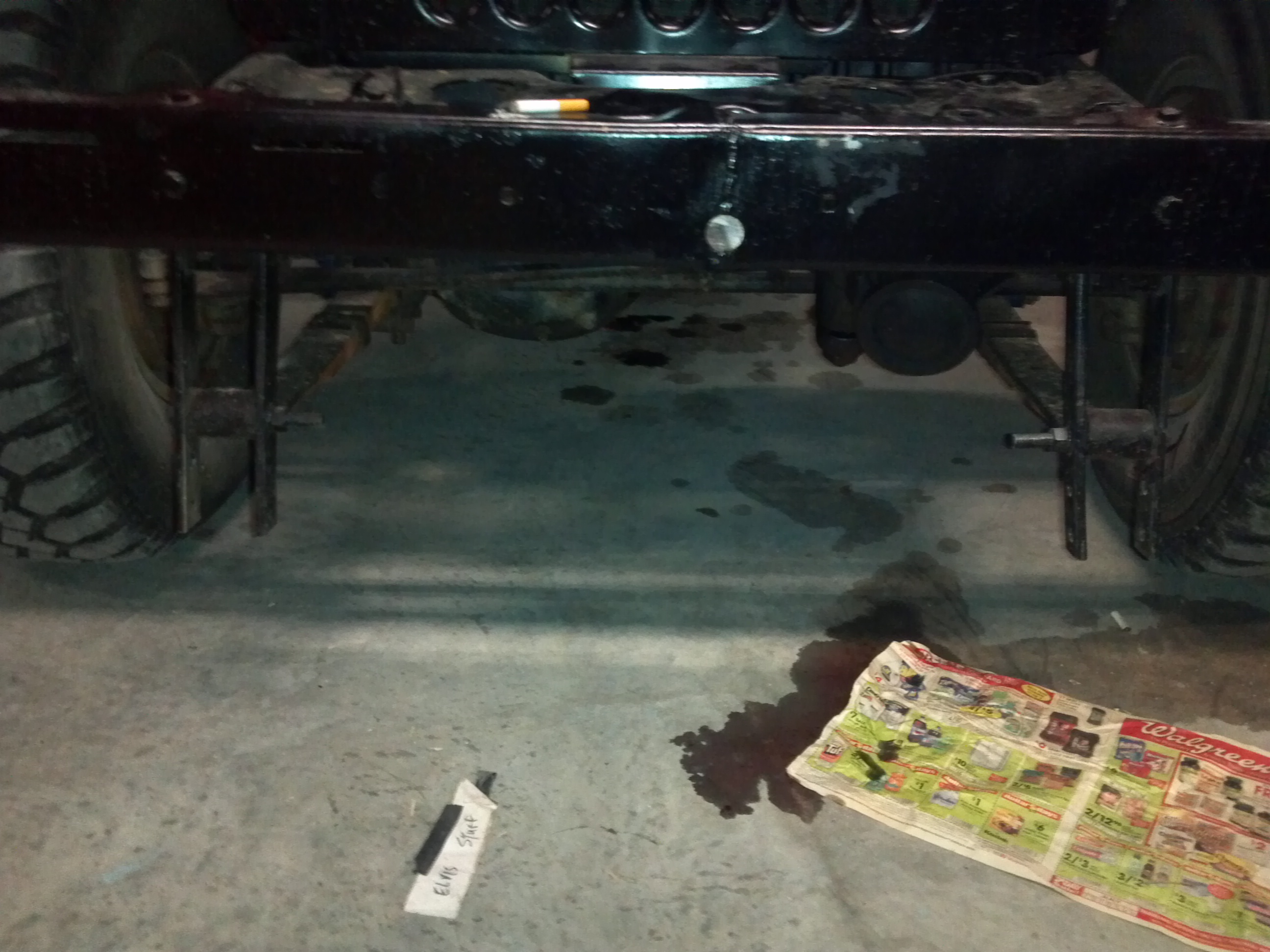

I got these big long shackles on the front and back. Bushings are completely worn and shackles do not move when 250 lbs of man jump on the bumper. Im guessing these shackles could be at least part of my problem, huh?

WOW, Those shackles are at least one of your problems, I gaurantee it! Too long. Get shorter shackles and your steering WILL improve, your can go up to 2" longer than stock (not 2" lift) shackle without problems, any longer and issues arrise. What happens is the longer shackles lift (atually lower) the jeep at only one end of the spring, which tilts your axle and changes the steering geometry due to the the change in the tilt. the longer the shackle the worse this is. (very simplified explanation) If you replace tie rods and rebuild the lower joint on the steering shaft, your problem will improve but still be there. Its the shackles causeing most of the issue. The 2" longer shackles will give you 1" of lift from them.
I'd put stock length shackles on it, grease the bushings and tighten down.. I don't believe in long shackles.. just have someone get in and without starting the jeep, turn the wheel and watch what they do..

View attachment 15465View attachment 15465
Good news is, my tie rods came in today. Bad news is, family Christmass getaaway this weekend so the earliest I can work on 'Luke the Drifter' again is Sunday night. Thanks for all the info and someone please let me know about these long shackles....
get rid of the big long shackles, get rid of the rubber bushings, get some hard bushings, not sure what they're made of, but they are black and hard, no flex.. i had wandering so bad, couldn't stay off the sidewalks.. just kept nibbling away until it got to just mild wandering.. changed out those stock soft rubber bushings and now she steers like a new jeep..
Well I guess I should have started somewhere else in correcting the wandering. I changed tie rods and ends, lower steering shaft, steering bearing, wheel bearings, and brakes. Steering is much tighter but still wanders. Dang shackles still got me. Real lift kit next I suppose....instrad of this crappy shackle lift...
Yeah, shackles were never intended to be used as a acutal lift per say.. they give you that little extra clearance that you may need to avoid some rubbing after installing a lift and larger tires. Over the years though they just keep getting longer and longer. If you are going to get a lift any way, you will have to replace the shackles anyway. I would start by buying smaller shackles, keep them close to stock, I think stock is around 4-4 1/2" so I wouldnt go longer than 5-5 1/2", stock would be best..and see if that fixes the problem. You should be able to drive on the street with you 33,s on stock shackles, its off road that rubbing becomes a problem with the suspension flexing.
