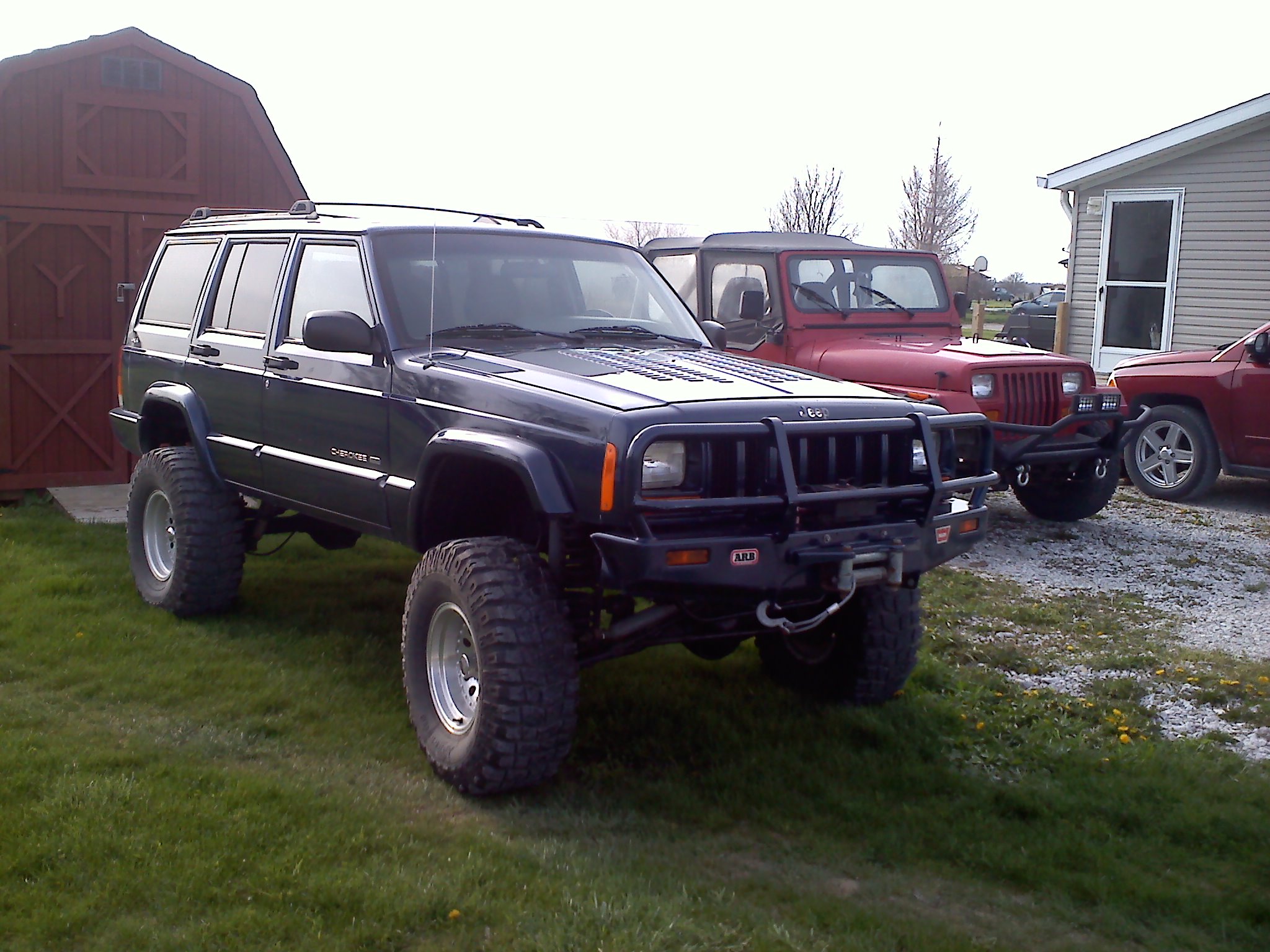

greg92 your right its a split ring that preloads the balljoint. sorry for the wrong termanology, thats what i heard someone call it. heres what happened i needed a knuckle so i ordered a good used one, then learned about the split ring and noticed the one i got did not have that and i
freaked and thought i bought the wrong knuckle. i was not sure if mine had it or not? so i have come to the conclusion that i dont need
the knuckle with the split ring. but reguardless if my vehicle has the knuckle with the split ring, the knuckle i got is what the manual advises i replace it with. i also ordered ball joints for it and it came with split rings? good thanks guys i have been searching for this info for days. i will
start rebuilding my front end now. thanks again fellas
here is a pic of the vehicle in question. My new toy!!! :D

Great to hear it will be roadable soonest ! Glad to help and that I had the right info for you too ! I didn't get it at first or would have replied the same time you posted . Just wanted to be sure of my research was right , but you got good people looking out for you in our forum so don't worry , the replies will roll in so you can keep your jeep on the road and off your drive way ! LOL !
All to glad to help if I can , hope to hear good news when you can , when your not too busy putting mileage on your new jeep !
Best of luck and thanks for your reply . Greg92jeepxj .
P.S. - wish my jeep were as shiny as your , working on it though
