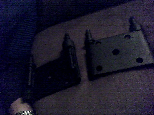

its going well. I can't work on it often because of work and school so its on pause right now. I did get the front end finished except for missing the mount where the shocks sit. so im looking for a way to mount the shocks
Before I can even start mine, I need to pop the body off and do some welding..
So I couldn't find the mount where the shocks go to on the yj so I simply bought some plates for the cj. Once I found out that they aren't wide enought to fit on the yj I cut off the male ends from the cj plates and welded them onto the missing yj part. I then sanded and repainted the yj plates. Here is the finished product. Lets hope its an ok mount for the shocks. It was welded pretty good.

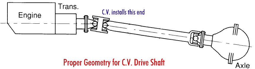

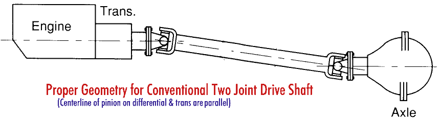

There's no set angle for any given lift, you just have to ensure the ujoint angles are correct for your type of driveshaft.
Unable to make the pic large enough to see anything.
