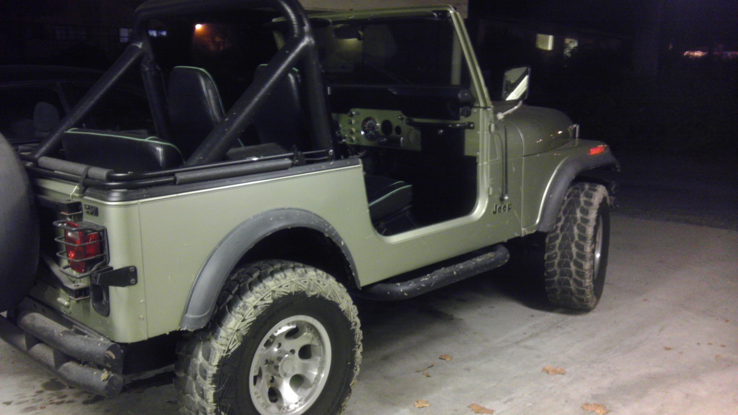

Can I get some advice on how I can get my 84 cj7 on the freeway in a manner in which the big 16 wheelers aren't passing me? Is it the gearing, the motor, what? I got the jeep from a English couple who didn't know too much about what was done to the jeep when they bought it. Honestly, can someone give me some specs by these pictures, cuz I have no clue.

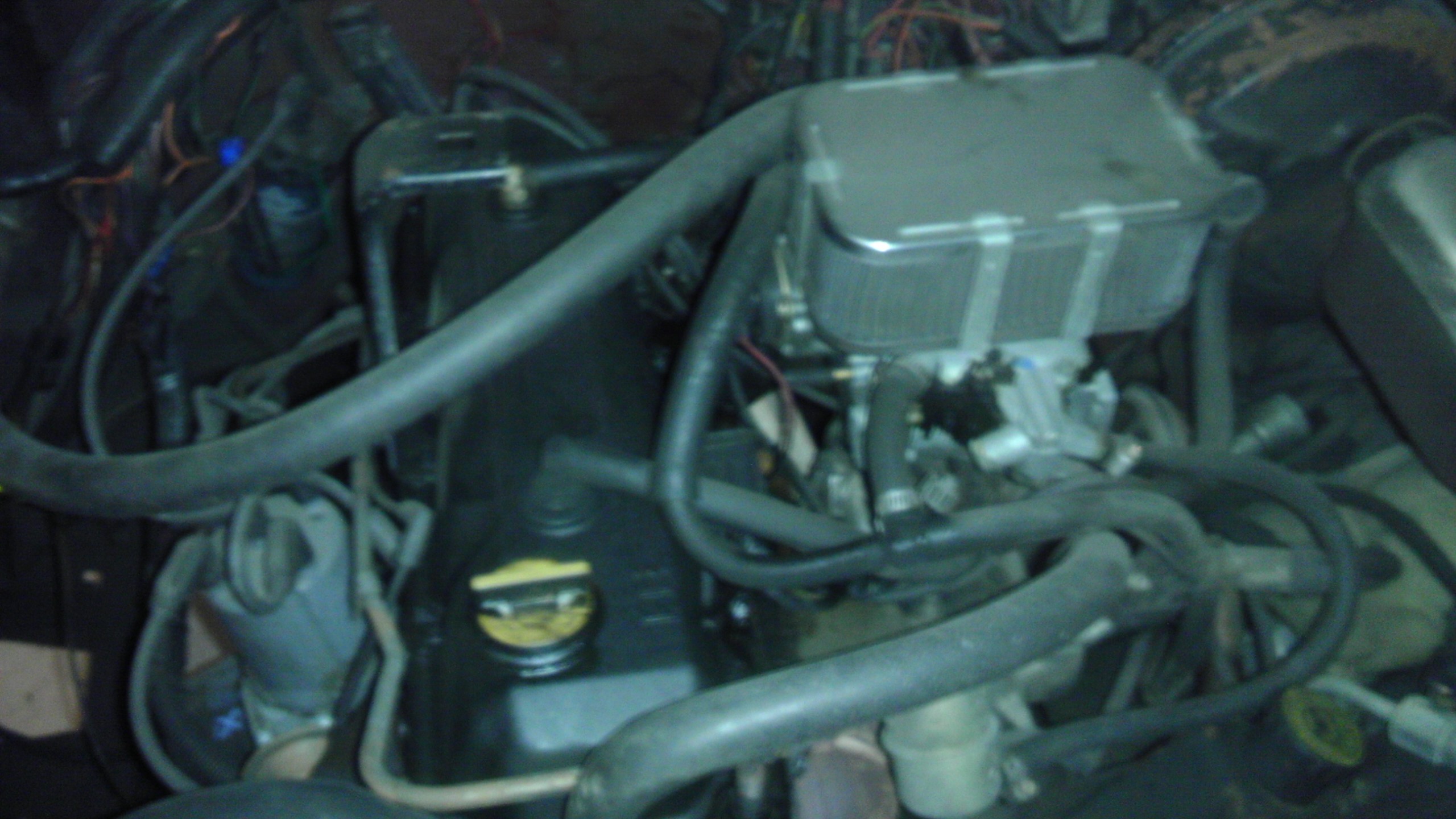

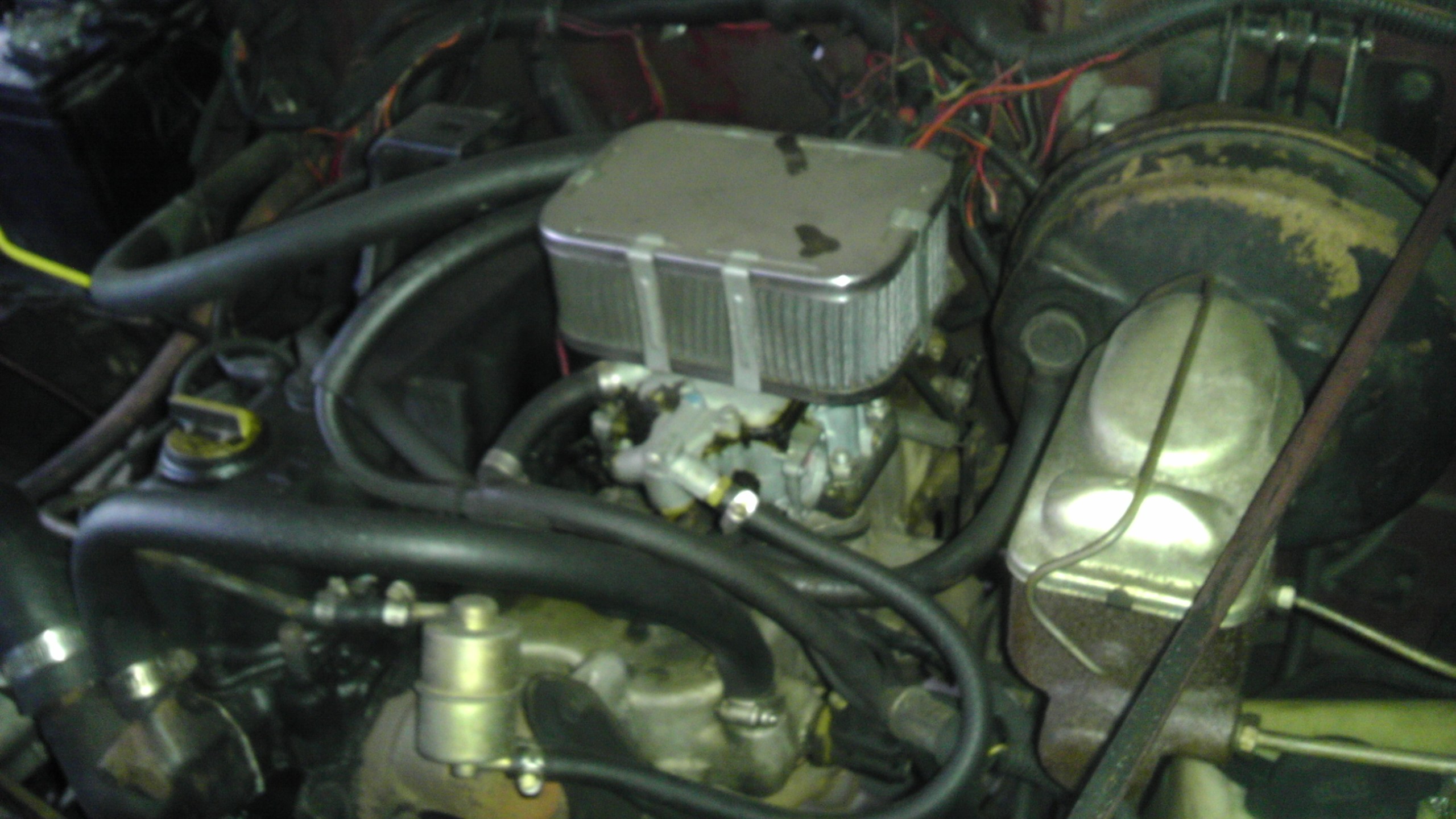

I noticed that you have an aftermarket weber carburator. Is it hooked up right? Is the cable adjusted so it gives you all the throttle that it has? are the jets adjusted right? Do have a tachometer? What is it reading when your going as fast as it will go? Maybe your gearing is too low but even with 4.11 gears i would imagine you could travel at highway speeds. And as far as those big trucks go, They've got a lot more power now days than they used to. They can maintain highway speeds plus easier than most cars. And, they've got 18 wheels not 16. How would you like to kick all of them to make sure one is not flat before you can start work in the morning.
What transmission do you have? A 4spd?5spd?auto? Also what size tires? They look like 31"s ,but it's hard to tell from a picture. What speed are you topping out at & is the engine whinning or just loping along? As Steadyfoot said you have a Webber carb....it is possible that your 4cyl is over-carbed.

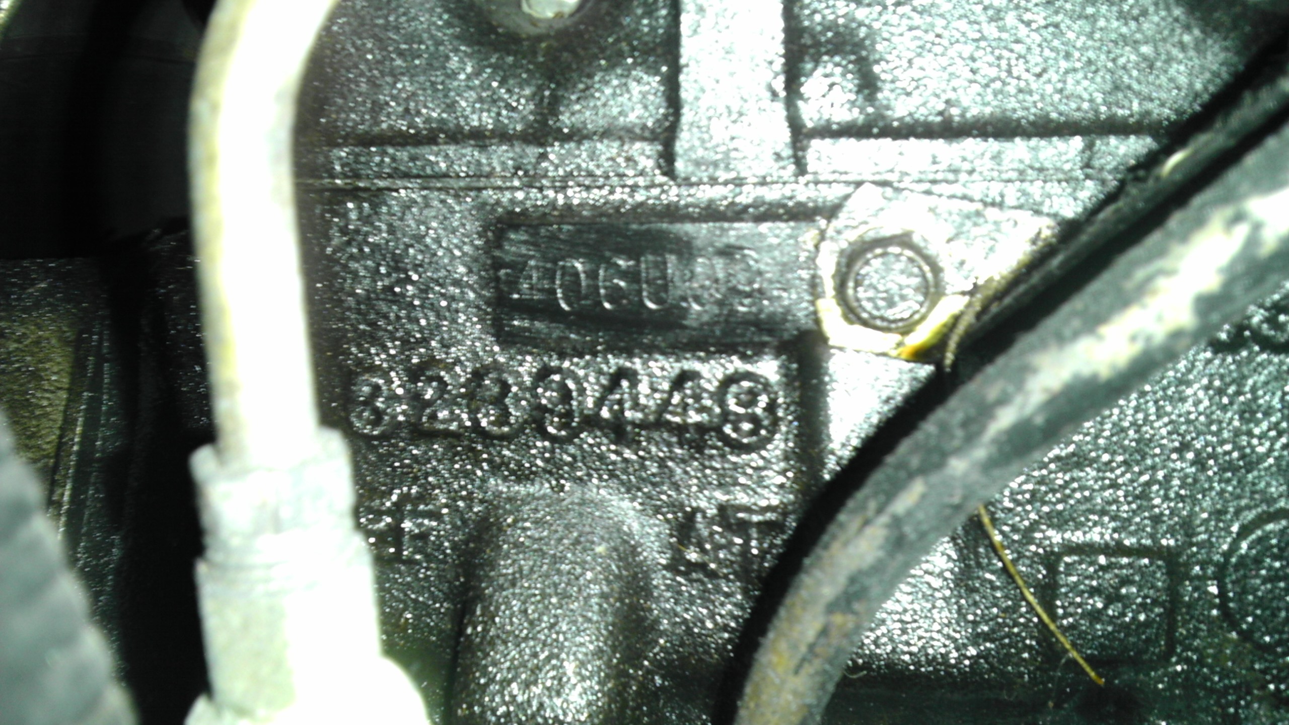

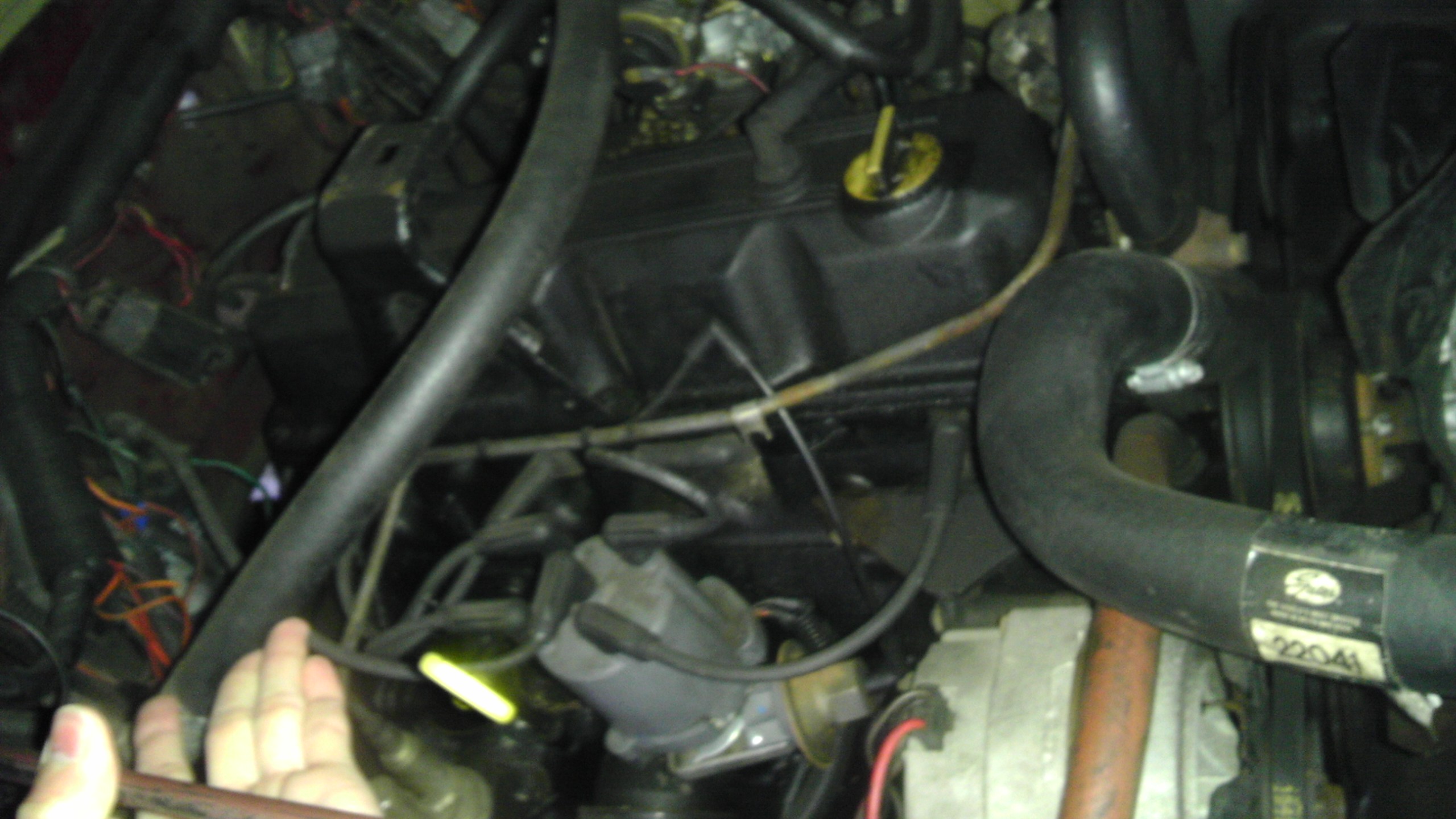

In the picture, the valve cover looks like a 6 cylinder(The angle of the picture is decieving) but if you look at the distributor it looks like there aren't very many spark plug wires. And it looks like one or more may be missing. The U in the serial number indicates that it is a 150 four cylinder. Can we get another picture of the side of the engine and the distributor. Does anyone else see the empty wire socket on the distributor cap?
and yeah, at best tune on that setup, you'll still have issues keeping up with tractor trailers a lot of places. not saying there aren't things that could be fixed, but not keeping up at highway speeds on that four-banger is not necessarily a sign of something not working as designed.

I'm new to this forum, but not new to Weber carbs. I had similar issues. Start simple! As the other gent recommended, check for free linkage/ full travel. After that, the number 1 problem is vacuum leaks. You also need to regulate the fuel pressure to 4psi. Lastly, rebuild after installing a quality tachometer, pay close attention to the float level.
Sounds like your secondaries are not opening. If you need more help, please get in touch with me. I have all sorts of references for you to use. Don't give up on that Weber. Once you understand them, there is nothing like them.

thanks steady.foot, here is a better picture of the side of the engine. hopefully you can tell me more about it. I'm running on tires sized 32x11.5x15.

Yup thats the 4 banger. Funny how it looked longer in the other picture. Even tho all 4 spark plug wires look to be in place, It looks like there's an empty socket on the distributor cap. I've never had a 4 cylinder so i'm not sure if it's what i think i'm seeing.:shades: Not sure how high an rpm that that engine runs well at but maybe with the larger tires a lower set of gears might help with more power and keep up with traffic too. The 4 cylinder guys will have to chime in on that. Keep it tuned up to the best that you can. You're working with a small engine.

When I look at the distributor cap I see 5 wires so to me nothing is missing.
