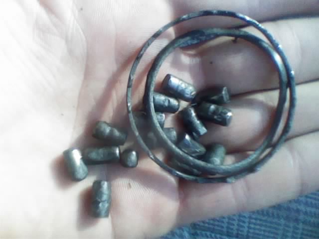

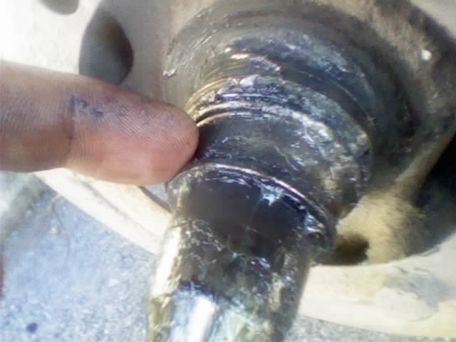

So I had this constant grinding and popping noise in my front end a few weeks ago, it finally got so bad that driving home from work one night it was actually pulling my steering wheel to the left. I figured it was the wheel bearing so the next morning I took the tire off, tried to turn the hub and it finally locked up completely. It could have locked up on the highway but she held together till I got home, took the hub off and sure enough my inner wheel bearings crumbled in my hand, oh well, that's what I get lol she's fixed now!
