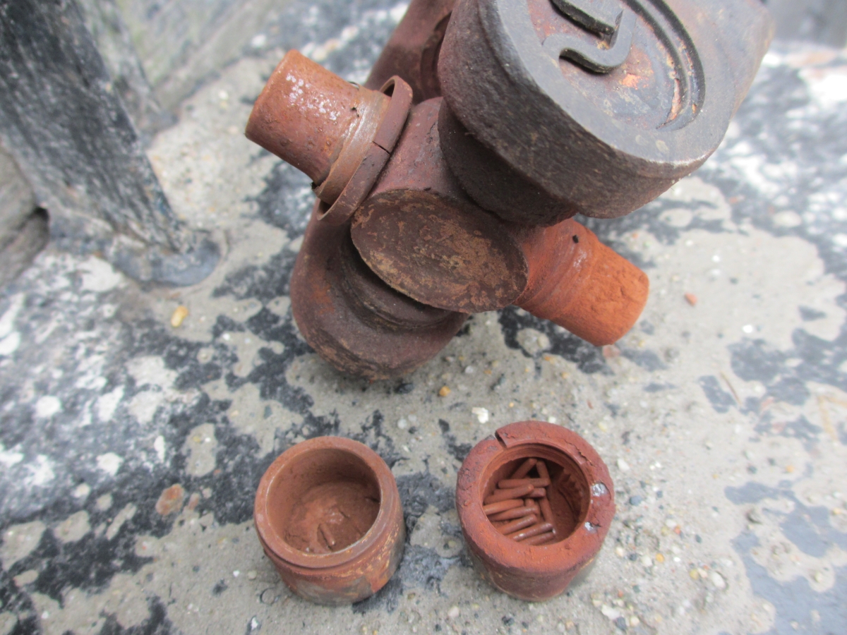

As per the photo , I'd say you caught that just in time ! The dreaded "red dust" means the U-joint was on borrowed time. Thank goodness for spring ! That u-joint couldn't go much longer without failure.
