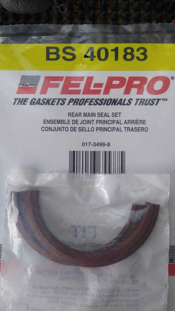

I'm not 100% sure what you mean by the tab or no tab on the seal. Here's the seal that I bought. Does it look like the right stuff?
Sent from my moto g stylus using Jeepz.com mobile app
Yes
Looks correct
Some sites parts lists are screwed up.
Drill down with year make model and came up with a part to an older 4.0 or 4.2
This will not fit
Same for my flywheel. They sent a 4 cyl flywheel not a 4.0 6cyl fly wheel

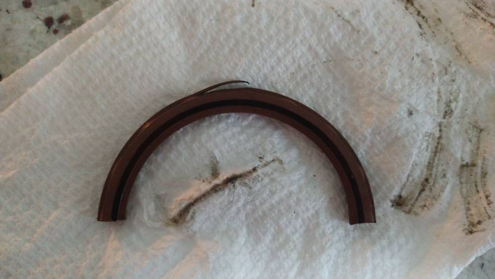

Im 50% done. I managed to knick the top seal trying to put it in so I had to buy a second set.
I tried lubricating the top seal with dishwashing soap and water but it was still a real bear. Hopefully I can get it tomorrow.
I needed to wash my hair three times to get all the oil out.IMG_20220305_171422297.jpeg
