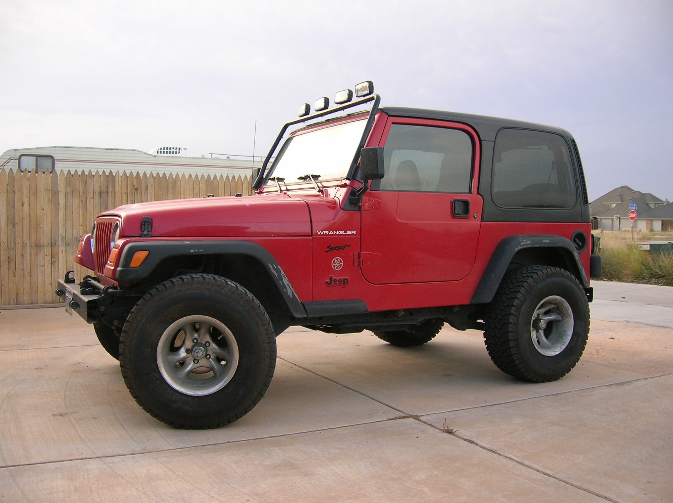

Here is a picture of my 02 with 33x12.5's and I think a 2" bb coil spacer lift, just to give you an idea. I haven't had any problems with rubbing or anything, and I also still have the stock shocks, probably not too good for it, but I'm planning on upgrading soon anyway.

A lot depends on the tire. One companies 33 might be larger or smaller than another. My old TSLs said 38 on the sidewall but actually measured 36. The new KM2 35s are between 33-34". The width of your rim will also make a difference. A 33x12.50 on a 8 inch rim will be taller than one on a 10 incher. If you plan on running factory rims plan on a 1.25-1.5" wheel spacer to clear the control arms. Def spring for new shocks, if you can afford them get mono tubes. You will thank yourself every time you ride on a rough road.
