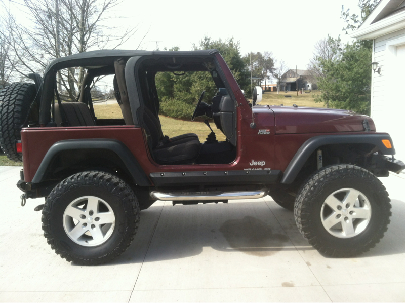

I have 35's on my 04 Tj and with 3" lift in the back and 4" in the front and had the same thing happen . Way to much lift for short arm. I ended up going with a pro come 2" all the way around with a 1" spacer added to the front to make it sit level, a drop pitman arm and a 3" body lift. It drives like the stock Tj setup did and has a nice stance.

Don't use a drop pitment arm unless you have a frame side drop for the track bar. You need stock pitment arm and an adjustable track bar. This will keep the track bar and drag link parallel and minimize wander, and bump steer.
Again 6 in is too much lift on short arms.
I have a pro comp adjustable track bar too. Luckily my wife works at 4wd hardware and I get great prices on everything.. Lol
