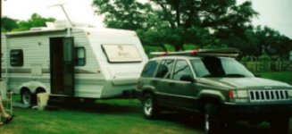

heres a pic

Looking at that pic with the camper-trailer, that ZJ 95 posted, you should have no problem... I know that my XJ weighs just under 4,000 pounds, that trailer is a lot more than that, and I am pretty sure that the Mazda weighs less than an XJ, so you should be fine :)
