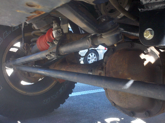

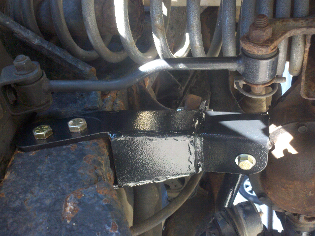

Hey got the new track bar all mounted up no more shake on the highway roles down the street better now too. Thanks for the washer trick superj that was way easier than I had expected. Ill post some pics soon.
Just a few pics of the new track bar.
