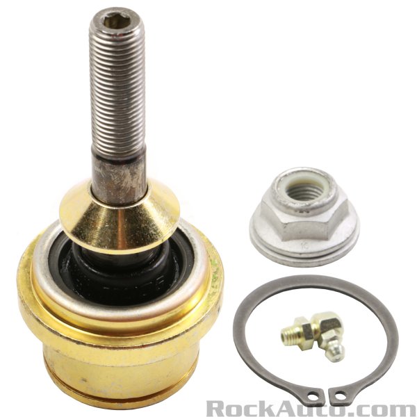

- The Moog BJ I'm considering at Rockauto doesn't appear to have a grease boot. Am I looking at this picture wrong? Is that black part a boot that will expand when it's filled up?

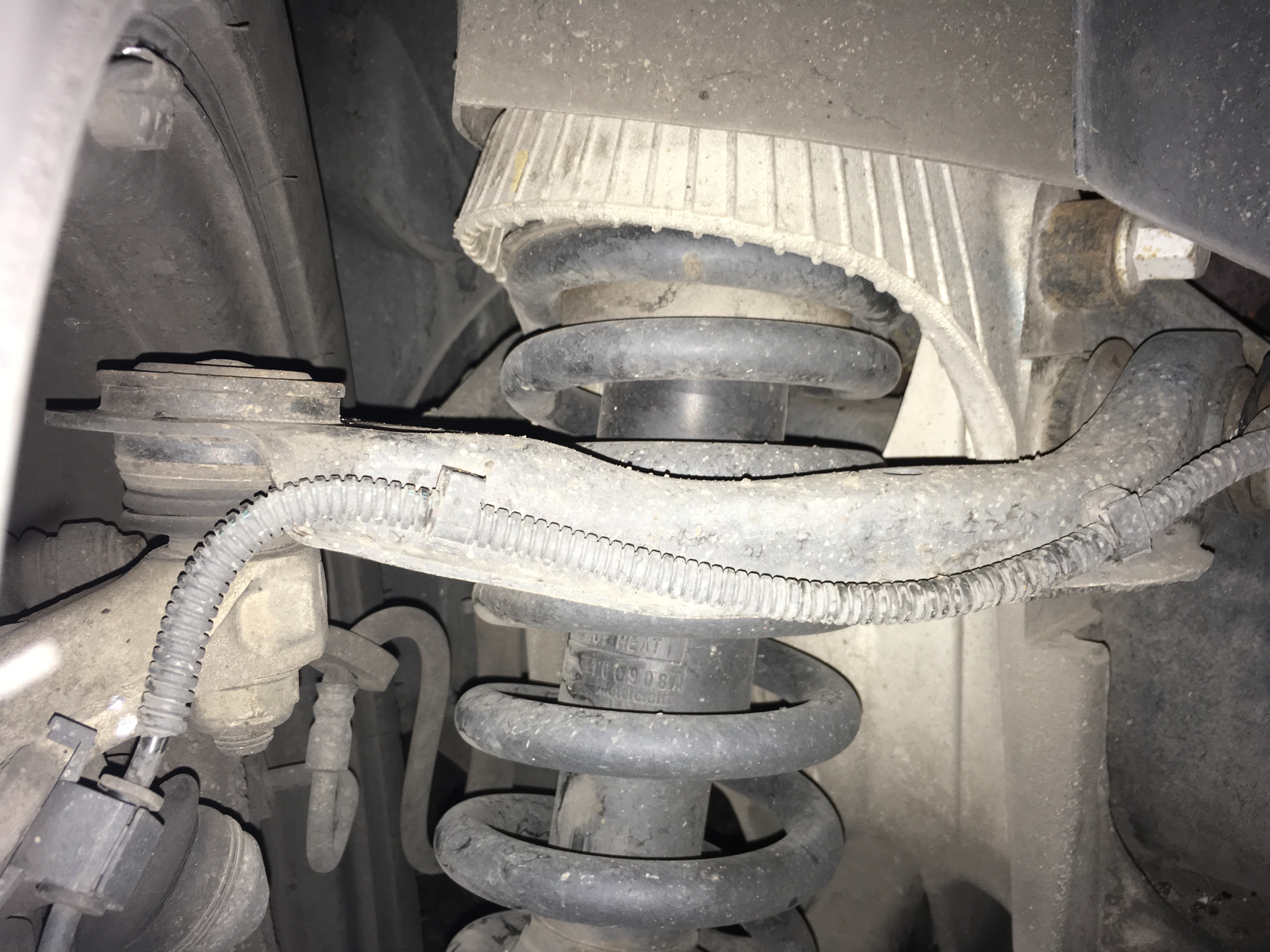

It depends. I don’t gave a manual for yours but if you post a pic I could tell you.
Some replace the upper arm and ball joint. Some have a pin bolt holding the upper in. Others are pressed.
Post a pic I'll post a video I saw but Im not sure how yours is set up.

The spring should never shoot out in a strut but post a pic.
Yes the black is the boot where the grease is beneath. It may not fill and expand out. The design is different for the cars design.

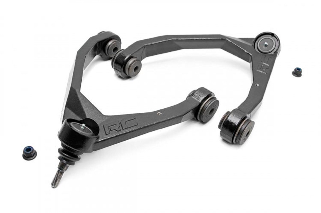

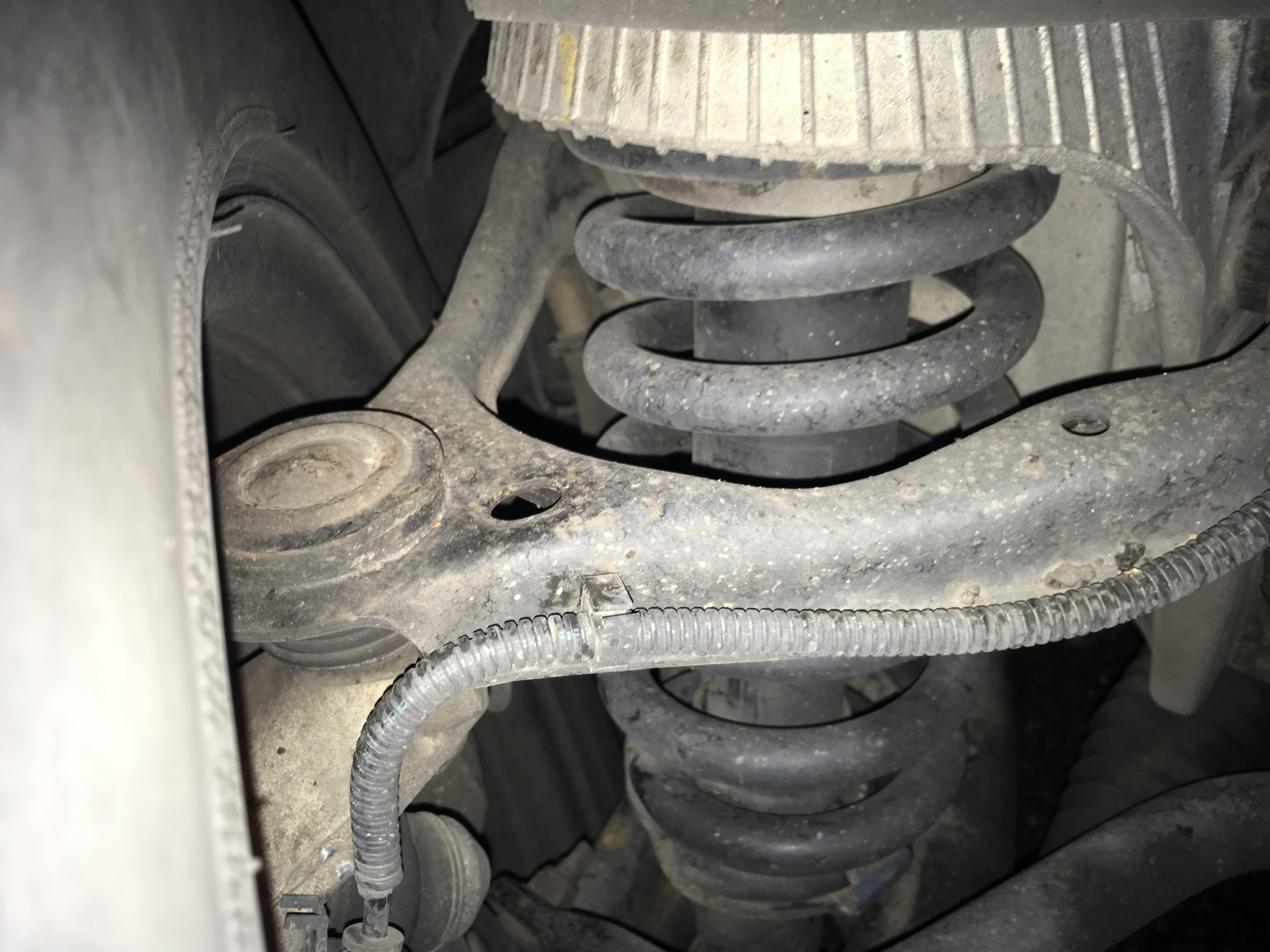

Do I have a stamped steel or forged top A-arm? I believe it's stamped but I'm not entirely sure.
Stamped
Stamped parts look like they took a sheet or plate of metal and bent it into shape with a stamp. The edges are sharp or square.
Forged is a piece heated and shaped as a solid piece.

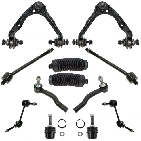

But considering the mileage I've decided to change out everything I can. Ordering 2 new top A-arm assemblies, 2 lower ball joints, 4 lower A-arm bushings, 2 new strut assemblies w/ springs, and 2 sway bar links. This only leaves the tie rod ends which there is a chance are not original. This car was part of a fleet that got regular maintenance so since I didn't see any movement at the outer tie rod ends when I was doing the 3 & 9 push test I'm thinking they may have already been replaced. I'll put in everything I've ordered and see how the steering is after that. Do you always do both inner and outer tie rod ends at the same time or is it common just to do the outer, or just the inner?
