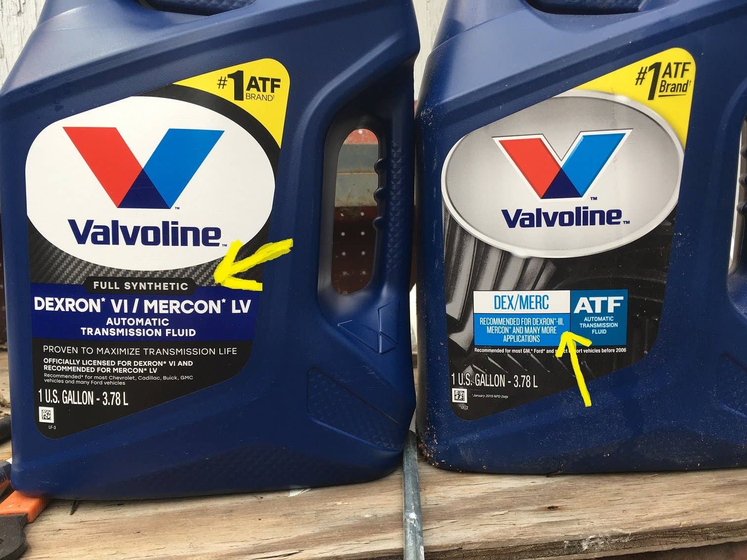

I was told a while back never to use any transmission fluid other than the Dexron III Mercon suggested in the owner's manual, even after the IV, V, and VI versions came out, superseding the III version.
Newspaper Font News Publication Rectangle
But this is what I'm seeing at the car part store now. Nothing lower than Dexron VI...
Automotive tire Yellow Motor vehicle Font Automotive wheel system
The one on the right says it's suitable for all Dexron III Mercon applications, but I'm assuming it may not hold up as long because it's regular fluid vs. the synthetic Dexron 6 on the left. Which one of these should I use in the old '96 XJ?
Thanks.
I wouldnhave no problem using the new3st version that says it meets the specs.
We do in our tj auto trans
It has something specifically to do with the AW4 transmission. For some reason, it doesn't like Mercon III substitutes, or I'm just now learning synthetic transmission fluid.
