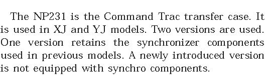

Is this the NP231 T' case? - look at ID tag for model th NP242 was possible.
see attachment for a note on NP231 ....

After reading your attachment it sounds like my case is the older version. So is it safe to just use the newer gears off the other case in the new shaft and not bother with the synchro?
either gears should fit the new SYE shaft - There was no question which set up (synchro or not) when getting SYE kit. I would go with no synchros.
Newer 231's didn't have the brass synchronzer ring, but they'll interchange just fine.
