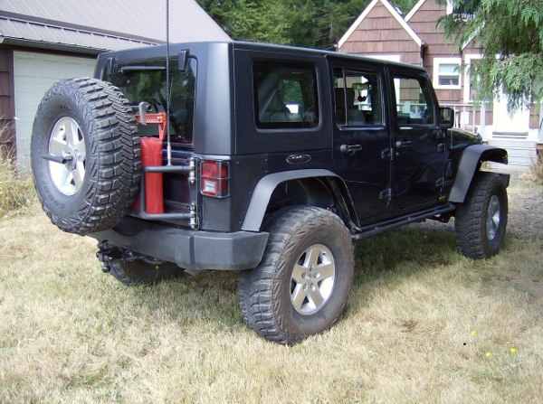

I really want this tire carrier!

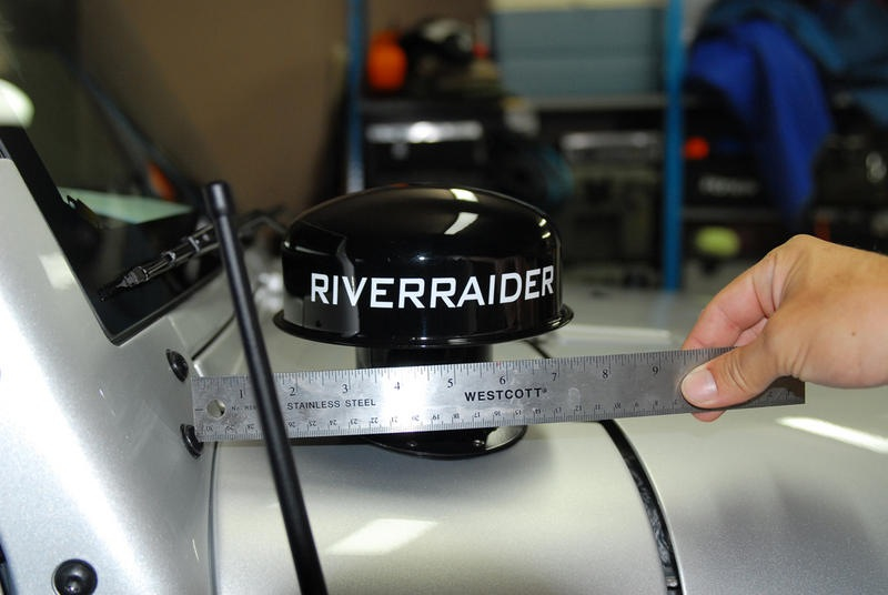

Then there's the river raider snorkel...

I like the look of a lot of jeeps that look like they rolled of an accessory line...but as for mine I like to keep it simple...I would want a winch...and new tire carrier like the one in the pic from scubadude...and some neopreen seat covers......OH and the most important thing...a hitch reciever for a basket to haul deer I get during archery season.
First off Scuba, I dont recomend this type of carrier, I have seen the damage they do when you try to climb something steep and slide back down...ugly!

Utah- what kind would you recommend! I am not a huge fan of mounting the cans on the side...

This style of tire carrier has one draw back....back into anything or slip on a incline and it destroys the rear door and both sides of the tub, as it pushed both sides of the tub outwards and dented in both mounting points, last time I saw this the guy said it was close to 6K of damage.
I dont know what to recomend if you dont like side mounted jerry cans.

Isnt the mount reinforced? Why wouldn't that happen with any carrier?
It is, but you have to look at it as to minimizing the damage, compared to the carrier. It is the reinforcing that is the main problem. When it hits something, something has to give, in this case its the tub that moves. Being forced in and side ways as the carrier spreads. This forces the tub to buckle along the sides near the rear tire well.
The off the bumper style has a tendencyy to smash in the rear tail gate if hit, a little more and you pull in the sides. At least with off the bumper styles you have a little room till you start racking up dollar signs. No method of mounting your spare is perfect, its out back with a hit me sign. I like the look and additions room the swing out has, plus with the tire protecting the jerry cans, but seeing the damage caused by a failed assent on a steep rock...
Hate to pull this subject back up but do you think the tire carrier would work with the aev corner guards reinforcing the tub?
Like these
