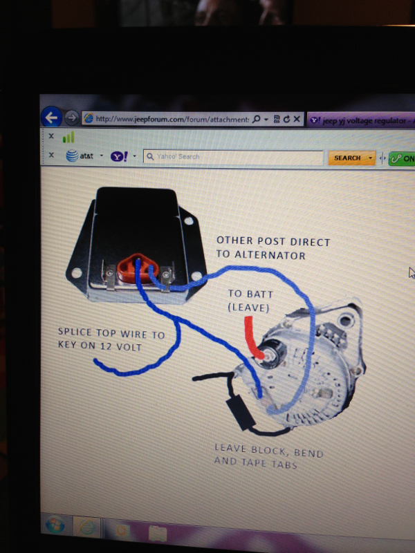

homeboundcat New member Apr 6, 2013 #4 Do you have a pic ? The reason is the previous owner butchered my wiring on alternator. Need to know where to get signals from
homeboundcat New member Apr 6, 2013 #5 This look right. Attachments image-2124586241.jpg 566.8 KB · Views: 1,154

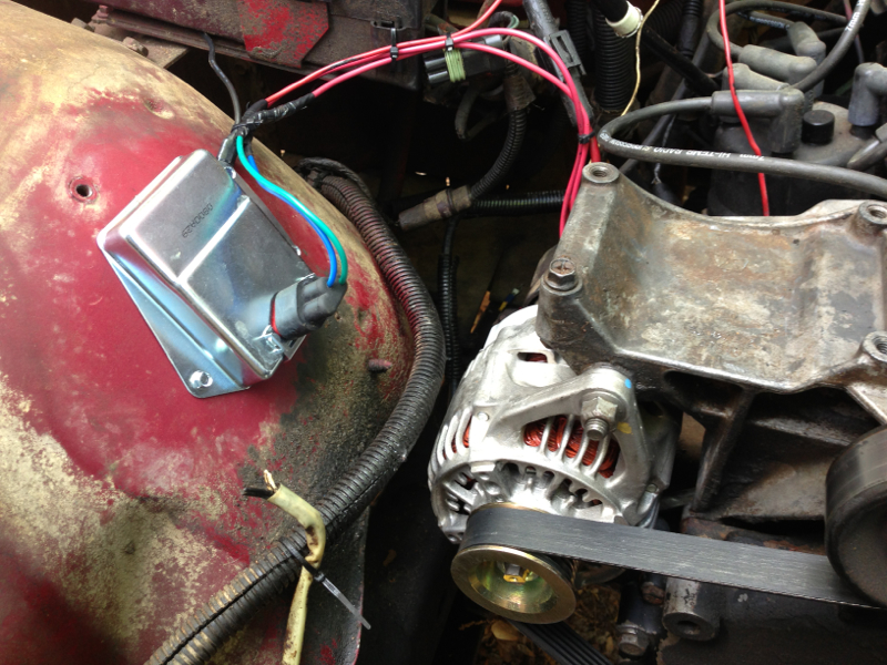

homeboundcat New member Apr 7, 2013 #7 Job would have been 10 minutes but the stupid made in china regulator didn't work. Went to car quest and got one made in America and it worked first try !!! Attachments image-3227759809.jpg 577.6 KB · Views: 3,519
