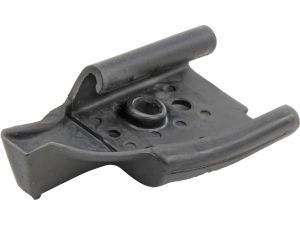

My 04 leaked from day one and we finally figured out what it was. On a soft top with full hard doors there is a removable plastic frame that goes around the door and attaches to the rollbar. Where that meets the metal of the body there was supposed to be a rubber seal. It was missing.
edit: just found a picture. It is called a mucket seal.
