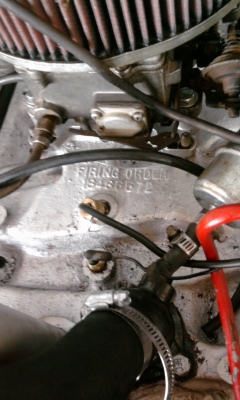

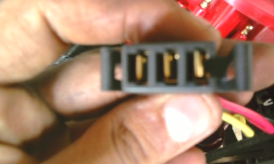

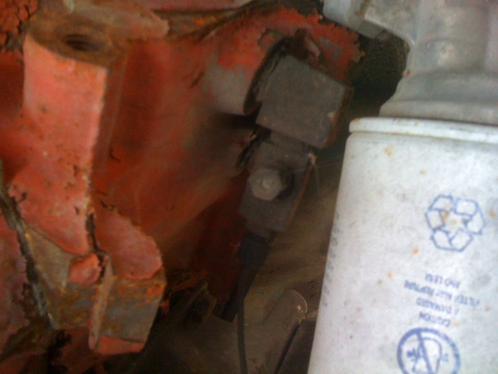

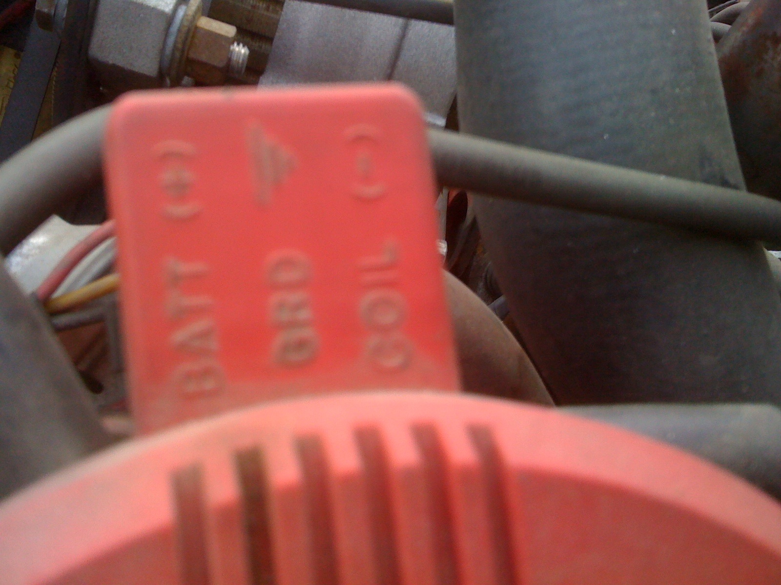

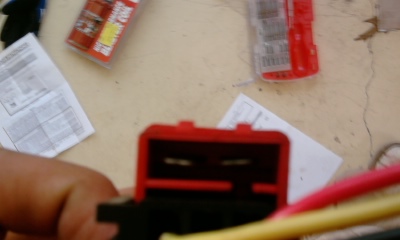

so I am about to finish an engine an engine swap from a 304 to a 360. now Im realizing that there is some difference between the 304 manifold and the 360. I need to lookup some parts that are 360 specific. only problem is that I dont know the names of the parts. can someone help me out?? I posted some pictures of the parts i'm talking about and i'll be adding more later. oh btw the second one is a picture the plug outlet on the HEI distributor, I put that there because I'm not really sure where to or how to hook it up.

First one looks like an oil pressure line that goes into a mechanical pressure gauge. Just a guess.....where does the other end of it go?
Yes, the first one is a mechanical oil pressure gauge line. There should be a fitting on the passenger side of the block just above the oil filter. although the filter is attached to the pump on the timing chain, the fitting is where the oil pressure sending unit would be. If I remember correctly, I could be wrong, on the HEI, one terminal is key on positive and the other is a ground. If no one else verifies this I will look under my hood and see if that's correct.

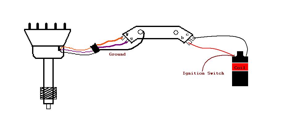

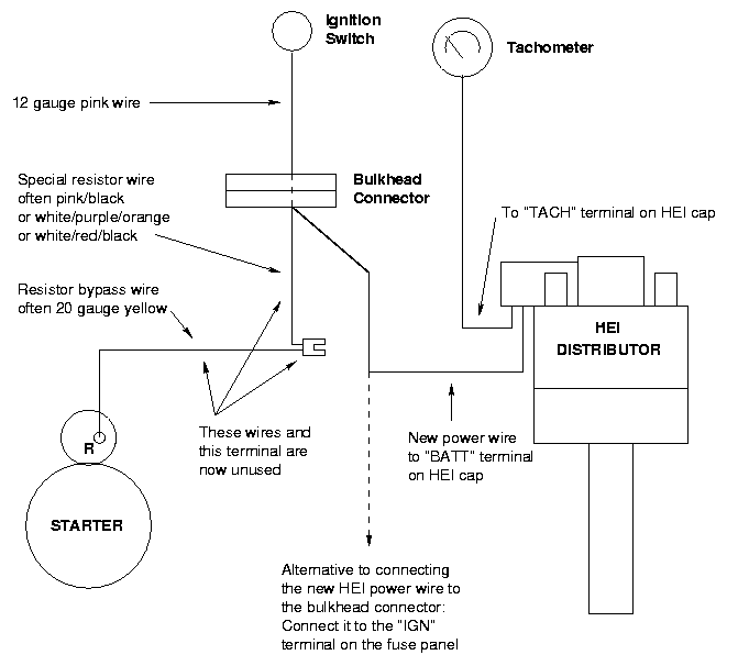

The HEI does not use an external resistor or coil. The coil is inside the distributor cap along with the ignition module. The wiring simplifies it to just 2 wires. Here's an illustration i found on the net.

idk about the oil pressure comment you had steelheadz. I only say that because the oil pressure sending unit on the block has a round piece in the block (the sending unit) and off of that there is a little tab. so I don't really see anywhere to put it. if you need me to I can post a picture of what I'm talking about.

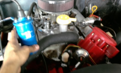

what are these? I think they are the same thing, not sure tho. the lower sensor in the first picture says temp gauge on the wire but the one above it looks the same (theres a closer up pic of it too) except it is longer then the other one by about .5". what is the difference between the two? also on top of that I had ordered a new coolant sensor(the lower sensor in the first pic) and it was engine specific but it's too small for the threads on the manifold. what should I do to close the gap?do I need to order another one? if so be specific about what to buy so that I can get the right one to fit. if not then could I fill it with gasket maker or is that a bad idea (kinda does sound like a really really bad idea now that I think about it)?

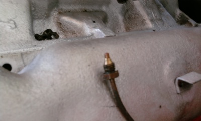

For the oil pressure , the line you have right now is for a mechanical gauge. On mine, i installed a fitting on the port where the oil pressure sending unit is attached to. I removed the sending unit since im using a mechanical gauge from Autometer. On the water temp probe, you will also need an adapter fitting that will thread on the intake and the inner diameter of that fitting to thread on the temp. probe. Your local parts store should be able to match you up with what you need. Make sure that the probe is recessed enough in the water port hole so that it can take an accurate temperature.

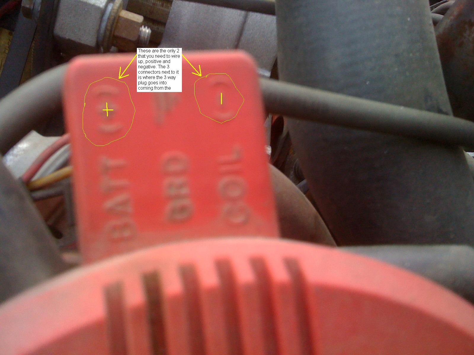

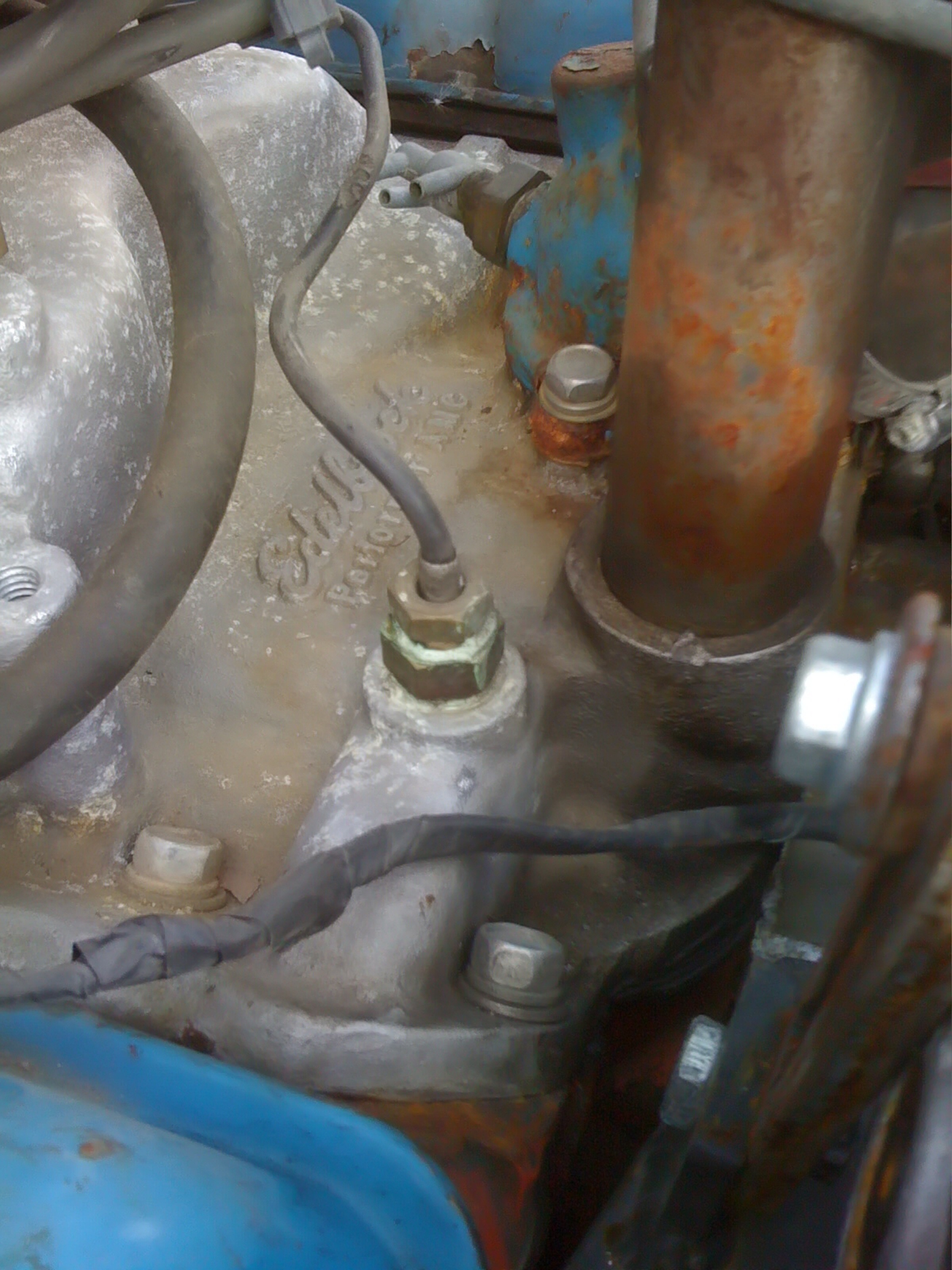

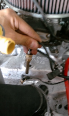

I hope the pics help. The first one is the water temp. probe. The second one is the wiring connection for the HEI and the last one is the oil pressure line on the right front of the block.

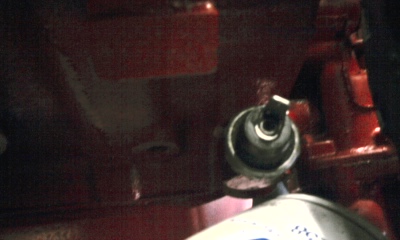

in the first picture is that large nut wielded to the block? also the hook-up for my 360 looks nothing like that. I think I might just get a new gauge that works for the sending unit that I have. unless you think it would be cheaper to ger the mechanical sending unit(if that is possible). I posted a pic of my sending unit so that you see what I'm looking at. whan I removed the sending unit in the picture the hole was too big for the "mechanical gauge wire thread thing".

What you have in this picture is an electronic sending unit. The Mechanical coolant temp. gauge does not use a sending unit since the probe is attached to the copper line going to the rear of the temp. gauge. All you need to do is find a water port in the intake to screw it in. On the first pic i showed you, i used an adapter fitting to get the probe mounted properly since the threaded hole on the intake is larger than the fitting on the probe. Also, use a PTFE sealant on the threads to keep it from leaking. On the last pic., I have a fitting block that is attached to the side of the engine block . Directly at the end of it is the oil pressure line for my oil pressure gauge. I removed the electronic oil pressure sending unit since i was not going to use it and just installed a plug on the hole hich is what you see facing upwards towards the camera.

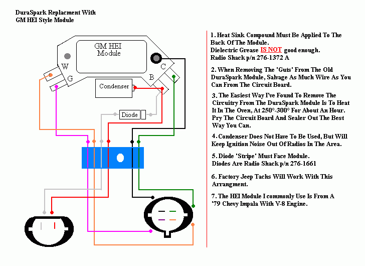

Ok never mind about the hei connection. I found this picture on line but I dont know what that thing in the middle is. do you?

NNoooooooo!! don't use an external coil. THe HEI already has its own coil and ignition module inside the distributor. That 3 wire connector plugs into the 3 way on the distributor cap. The only wires you need to install are the 2 wire connector next to the 3 way on the distributor cap. I took a picture of the top of my distributor. The 2 on the outside section is the only 2 wires you need to hook up.
That thing in the middle your reffering to is the ignition module that's inside the HEI distributor. Just use that illustration for refference when you plug in the connector to the distributor cap.
