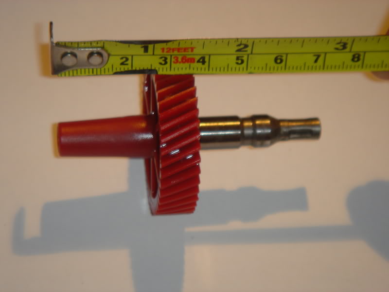

OK, so now I am back to thinking that I am needing the short version rather than the long one... I checked out the long ones on-line, and they just look too long. What do you guys think?
This one is lengthwise. Looks like the short one...

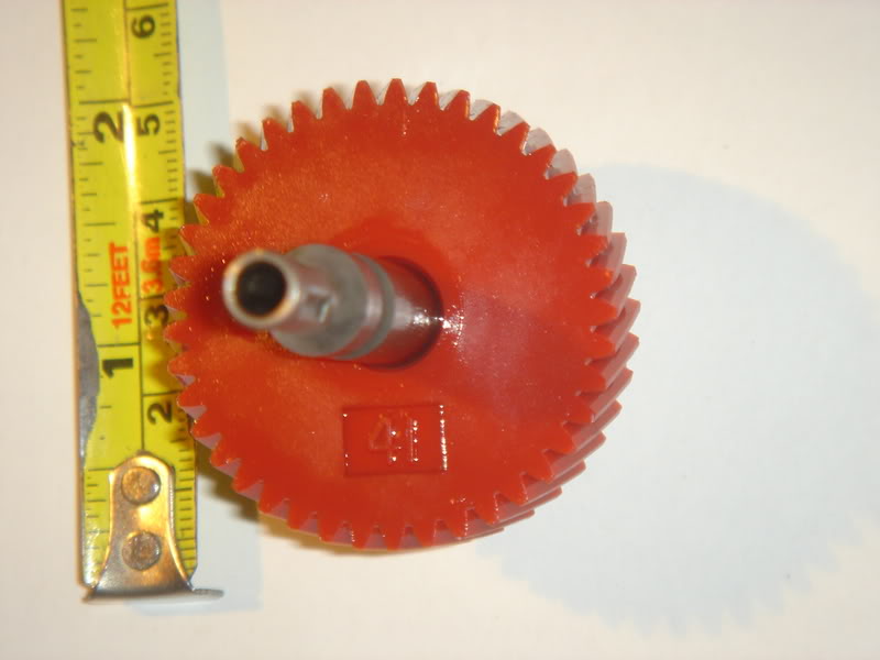

This one shows that it is a 41 tooth gear; the diameter of this one, however, is significantly thicker than the one I got last one (I'd like to say it was a 38 tooth one, but i do not remember for sure).

Actually, the size I need according to my calculations, is exactly what quadratec recommends. And since the tires are staying on for about 2 more years, I'd rather have the right speed on the speedometer, and distance showing in the odometer.
Felipe
