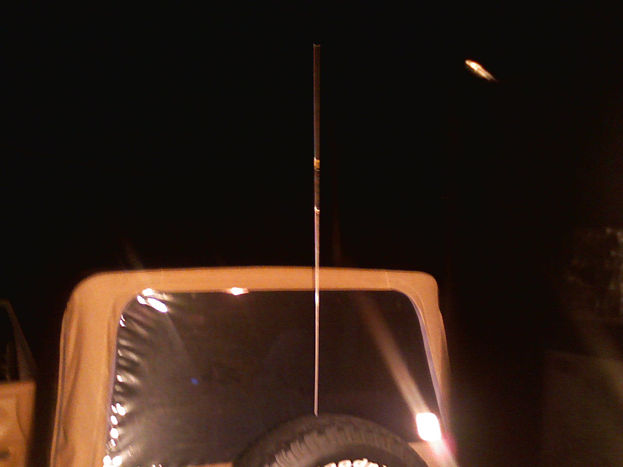

Mines right here in my spare tire mount.

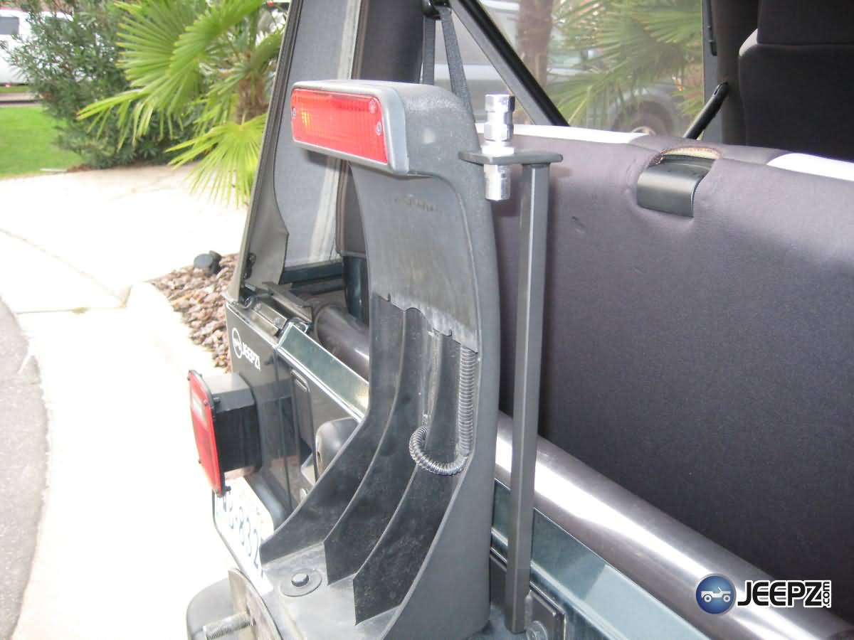

I don't have a CB antenna on my YJ.... yet. On a friend's YJ I installed the CB antenna on his spare tire stop that's attached to the corner of the body. It worked out well. Just marked the location of the bracket holes, drilled the holes into the tire stop, and installed the bracket. Took about 15 minutes.

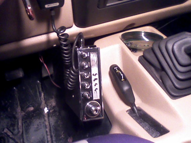

Mines right cher'.........
