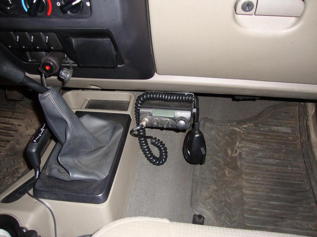

I placed mine below the glove box tucked back in the corner by the trans hump on the passenger side. There is a metal lip under the plastic molding that gives you a great place to tap some screws into, and no one whos ridden there has had an issue with clearance..

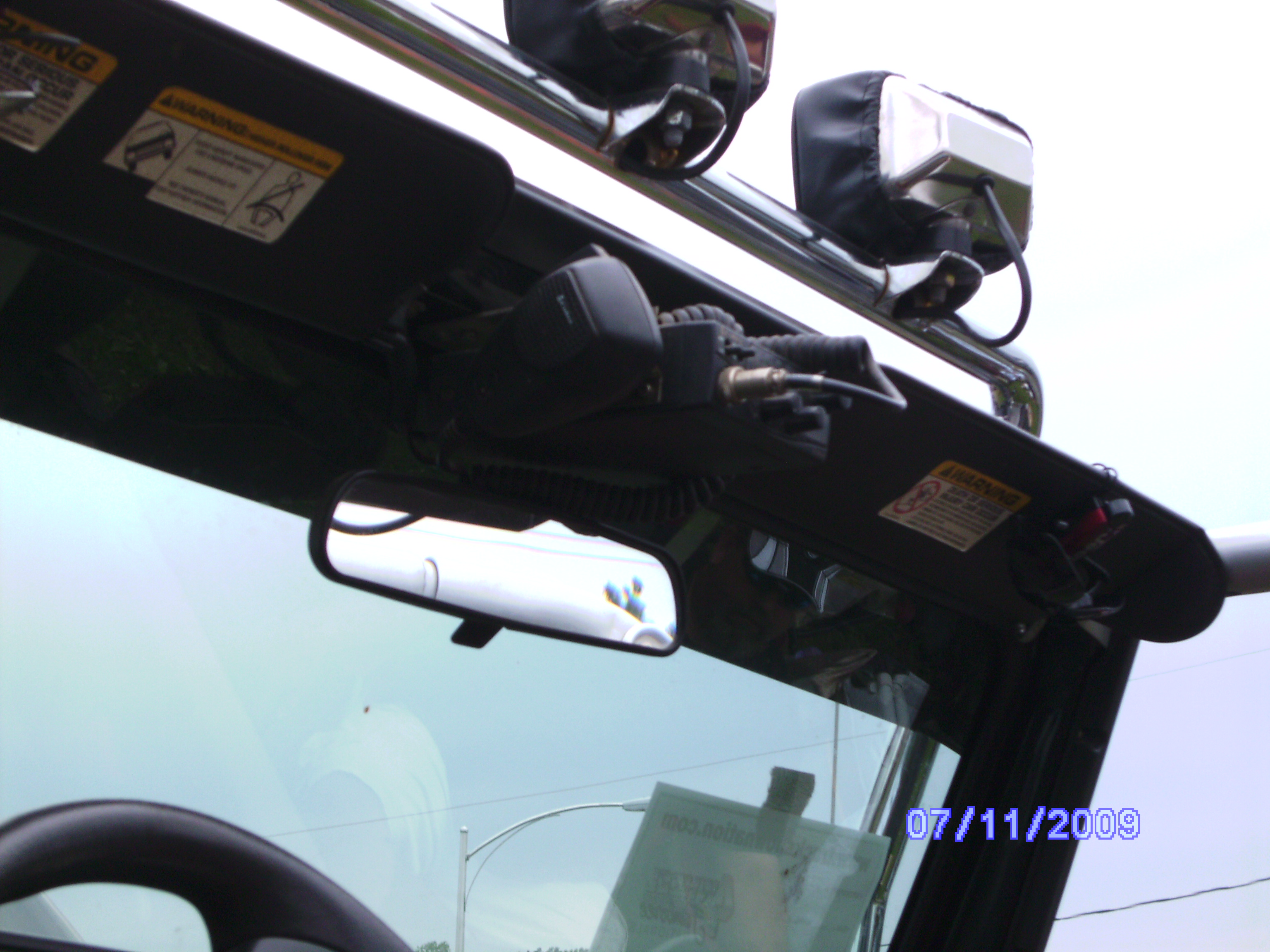

if you got a center console i would recomend to install it there easy enough to protect if ya got the top down or off in case of rain..because you dont want to lose your investment to mother nature. my hard top never comes off.(bad back) so mine i added a 3x1/4 flat stock between my roll bars so the radio is just above the mirror so i can reach it easily and mic is attached to dash board by mic clip you could also add a gear keeper for around 20 bucks puts mic on a retractable leash so its allways out of your way

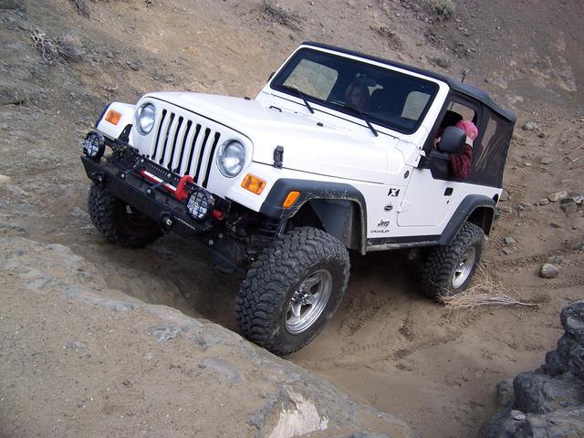

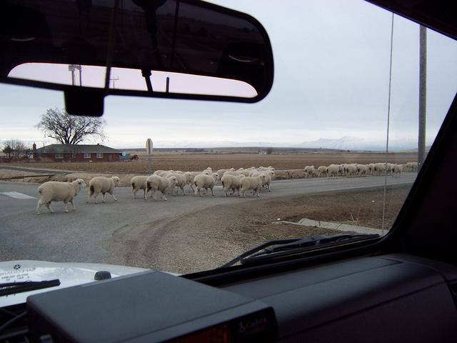

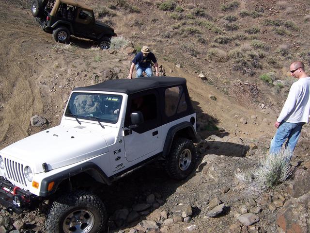

I'll try to find some pics but I had mine mounted right on top of the dash in the coin tray. It may sound tacky but it worked perfect for my little Cobra 19 (The uniden would fit perfect also).
I removed the rubber mat and used some washers to mount the bracket then ran the wires between the dash and windshield.
If you look close in these pictures you can see it right in the middle of windshield.
i put mine in the same place..
