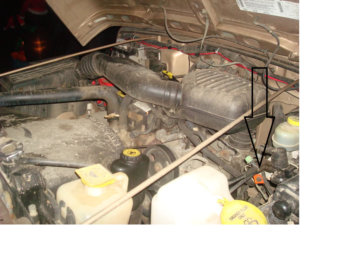

Where does this hose go?
GAjeepGirl85
Replaced my radiator, hoses, serpentine belt, water pump and thermostat. At some point during that process I knocked a hose loose. Have know idea where it goes. It is one of the two hoses with the arrow in the attached picture. I don't even know what that thing shat they are coming out of. Please help!!!
I was able to locate where it went this weekend, while I had more time and light. Hooked up to a little tube coming out from the housing underneath where the throttle cables are attached. All is well.
