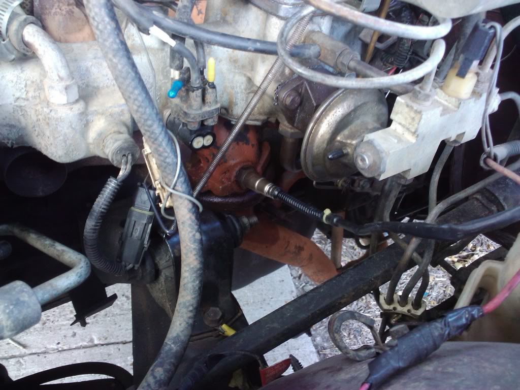

since i no longer needed the factory o2 and i was wondering how the jets in this holley were running, i installed my innovate lc1 wideband. i am still resoldering hte controller wiring but once i get it all done, i can just hook my laptop to the plug and drive around and see what air fuel mixture i use the whole time. then, i can make any adjustments if its needed and also, i can be ready when i do other mods so i can see what adjustments need to be made then.

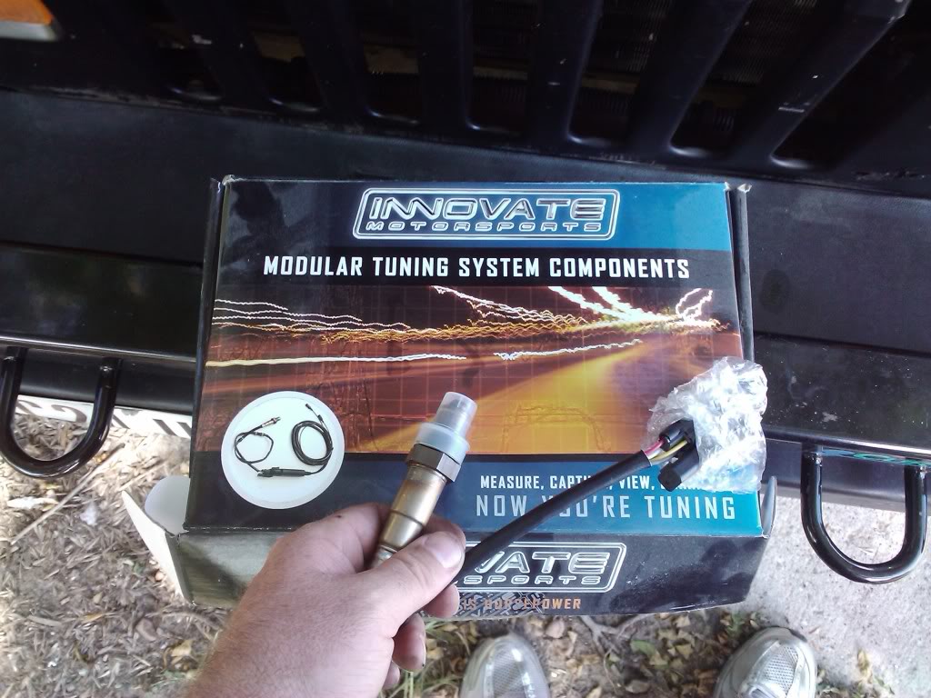

this is the kit. i have had it for about 5 years because it went with the stand alone i built for my bmw while preparing to supercharge it for autocrossing. stand alone didn't work out how i wanted so i removed it all and this has been on the shelf ever since.

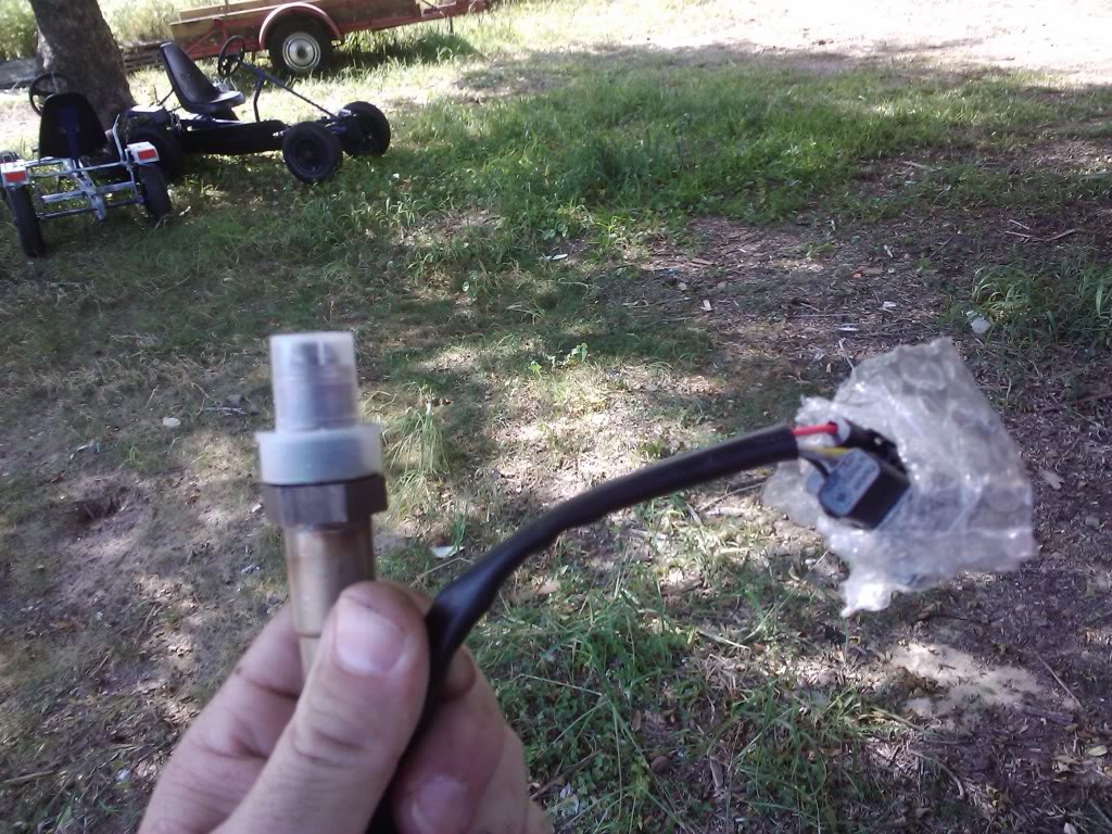

this is hte actual wideband o2 sensor. if i remember right, this is a ford mustang wideband o2.

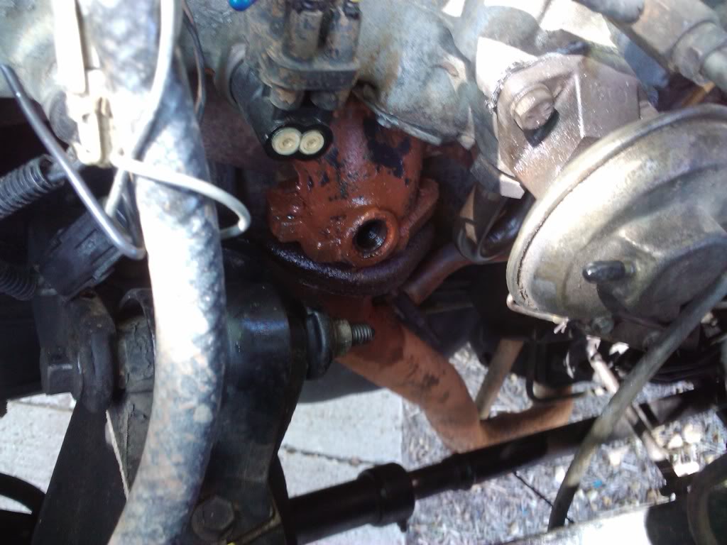

this is where the stock narrow band would go and it unthreaded very nicely
here is hte wideband threaded in and ready for the controller

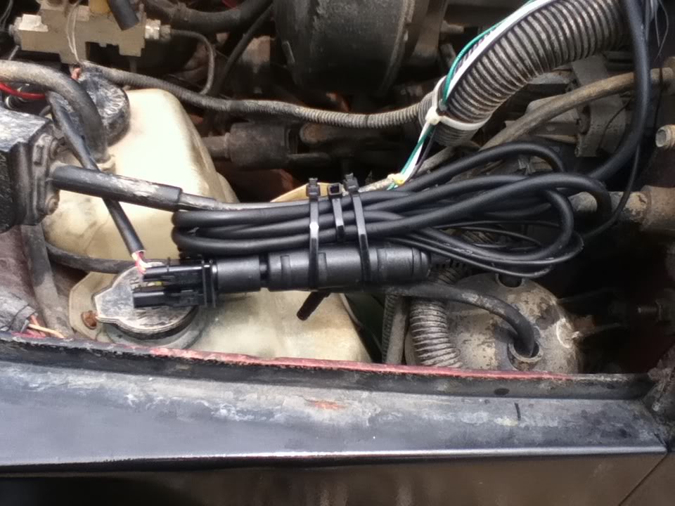

Here is the controller. I attached it to the stock cruise control sheathing

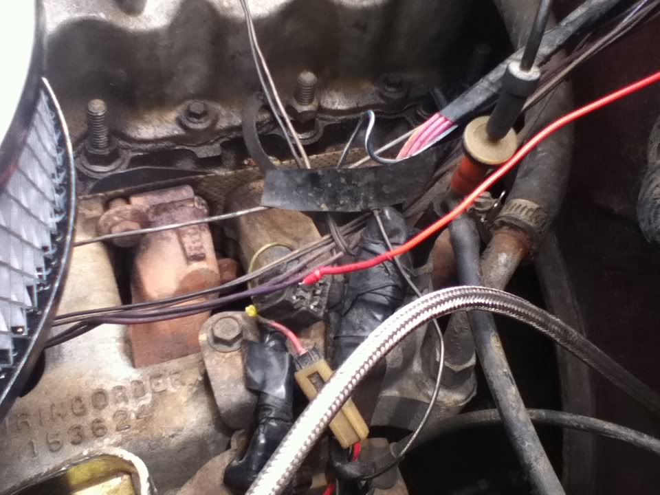

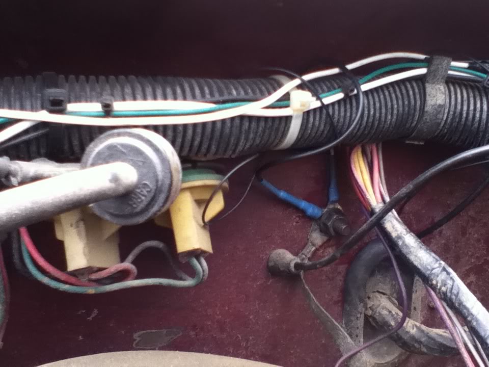

Here is the power. Turns out it is not a good spot so I will to move to another spot and make a better real connection

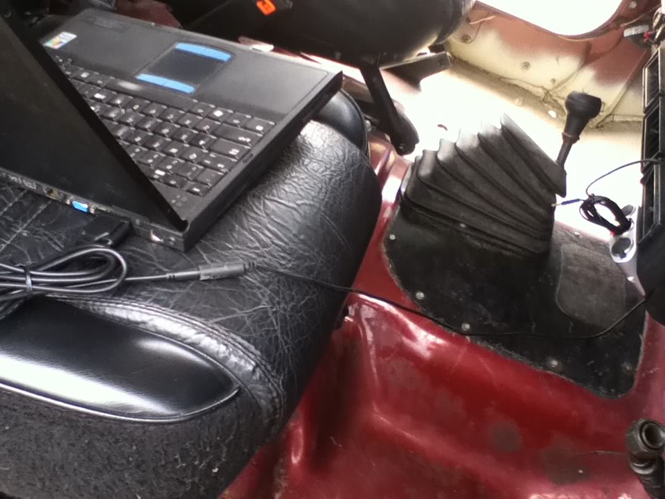

Here is the wire from the controller to the laptop. I didn't use this laptop for the run because my son didn't plug it back last time he used it so you'll see later I had to use some adapters
This image has been resized. Click this bar to view the full image. The original image is sized 960x720.

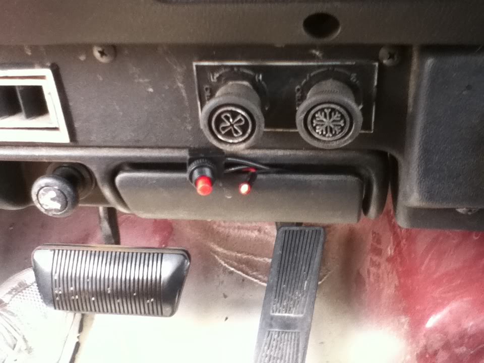

Here is the reset button and led. The led stays lit to let you know your good but if it starts flashing then you have a connection error somewhere

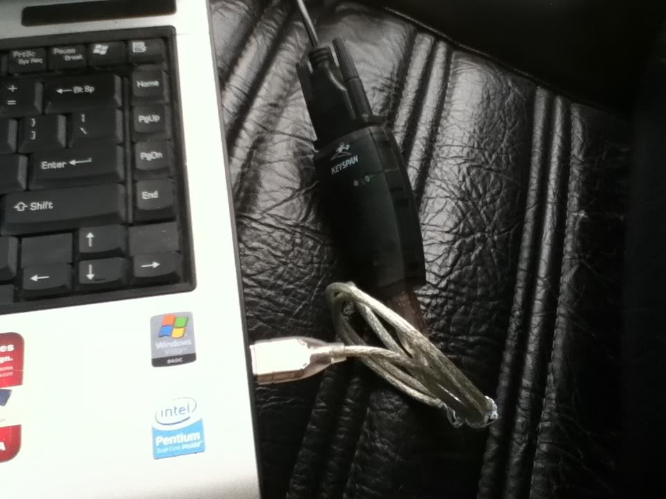

This is a serial adapter to use a newer laptop that only has USB plugs

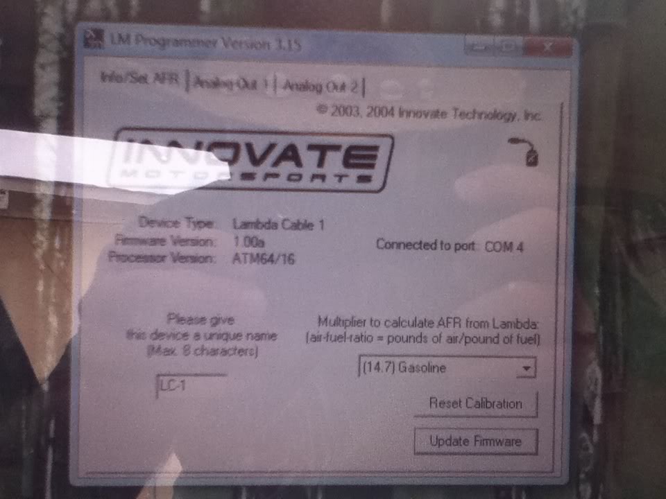

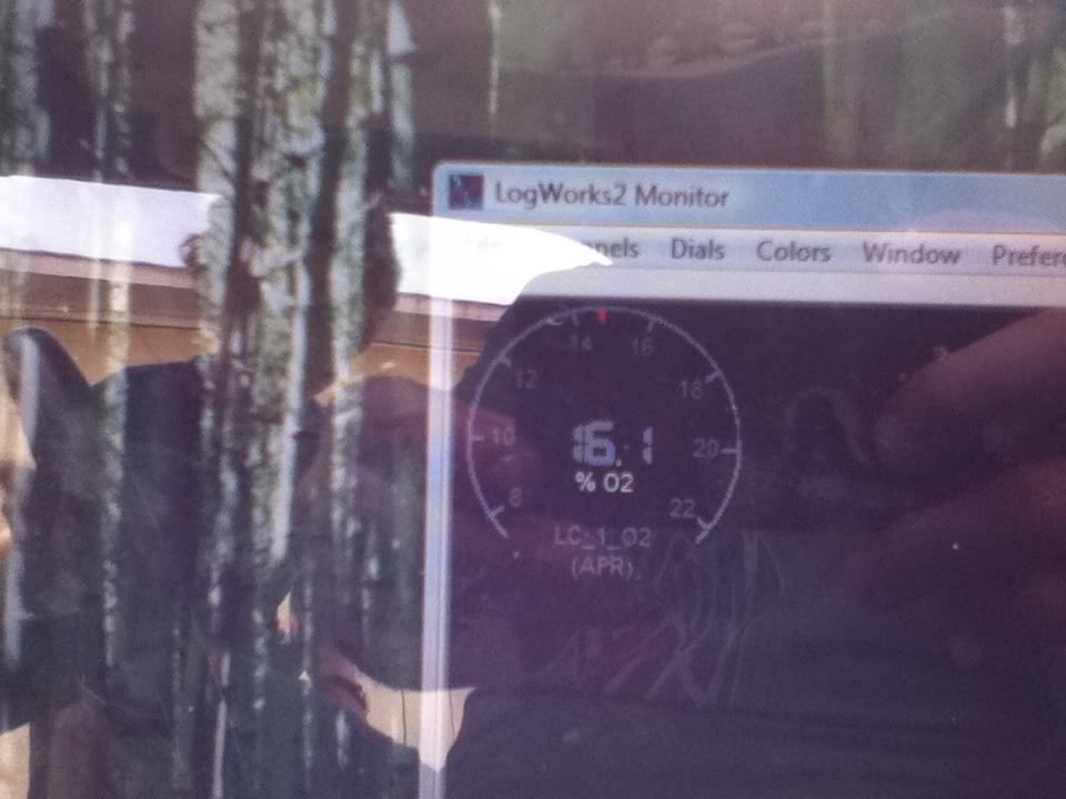

Here is what pops up when you turn the jeep on and run the programmer to make sure you are hooked up right
This is where your a/f ratio is shown when you plug your laptop in
